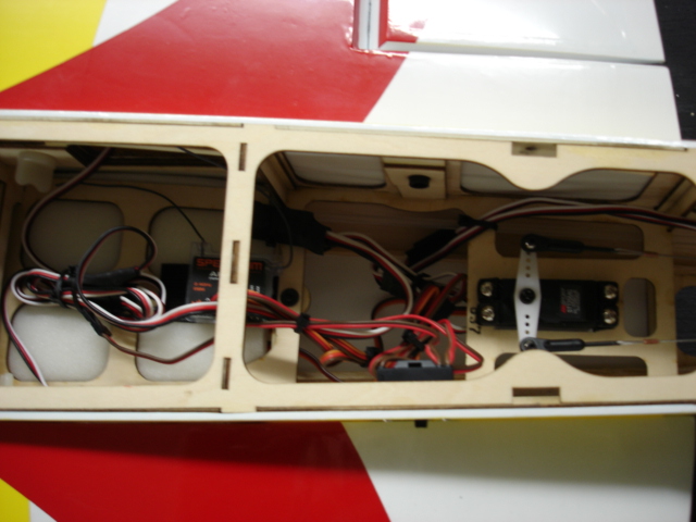

About the plane.
Out of the box it is real nice all the covering is perfect the fus is built real soild. I like the built in vert.stab.
all of the parts are good quailty. (did not like the 2 1/2 stockwheels to small)
the built was standard hanger 9. every thing when together nice ( 2 evenings)

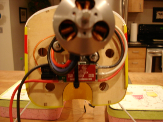

I cut out a vent on the bottom of the fus. their is a 1"x5" pattern in the bottom of the fus just behind the wing just cut the covering out.

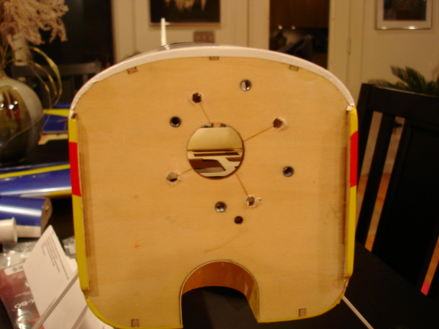

next. mount the motor:
I drilled four 1/2 holes in the fire wall for venting.
Next center the x Mount on the X that is on the fire wall. mark your 4 mounting holes.
use a 1/8 drill to Drill the 4 holes then drill it out for a #8 screw.

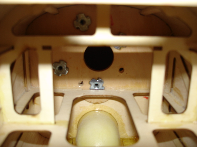

at this point I was going to use T nuts on the back of the firewall But the bracing is in the way.

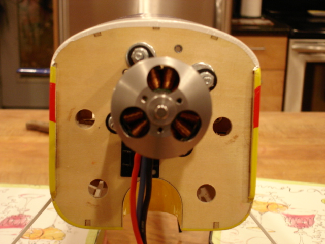

So what I did was use 3" #8 /32 screws put them in from the back side of the fire wall. I used a small washer on the back side and a large washer and nut on the motor side.
use medium blue loctite.
then I used 1 1/2 spacers and mounted the motor on the 4 screws as seen in the pictures.

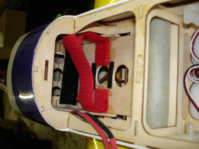

I mounted the ESC on the bottom of the fire wall just below the motor using cable tie mount.
then I bult a battery tray that fits in were the fuel tank would be the 4 batterys fit perfect.
the CG was right on.

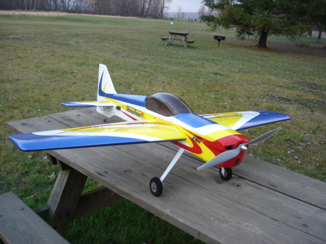

I checked the weight of the Showtime 50 without the 4 Li-Po Batteries. 6LB w/ RX Battery. on the nose that is on a FE EX Shipping scale. also here is some pictures of the battery tray. Have not had a chance to fly. I did build up a Hanger 9 P51 PTS

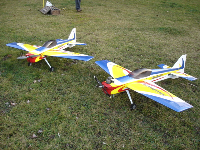

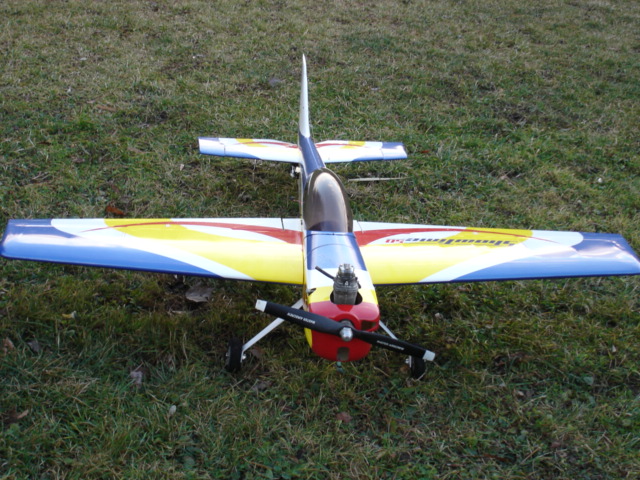

my buddy who has been flying rc planes for over 20 yrs. and is a certified full scale flite instructor. test flew both the gas and electric showtime 50. we set both planes throws up the same.
the gas plane is powered with a Enya 80 4 stroke. 6.2lb dry. 7.2 wet (prop. MS 14x6)
the Electric plane is powered with a E-flite 60 /CC 80amp esc. 4 TP11.1v 2100 15c/24c Li-po's. 6lb dry. 7.24 w/bat (prop. APC 16x8)
flite times averaged 15min for both.
the gas plane has more (brute power) very heavy feel. lots of power. it does not slow down as well as the Electric. it tends to want to stall and nose in. all of the stunts were very good. hovers vertical pull out. all very good.
the electric plane. the first thing you notice is how light the plane is in the air . it will slow way down before it stalls. it has very good power. there is no hesitations or hiccups after extreme maneuvers.all the stunts were very good . hovers vertical pull out very good. much more graceful than the gas version. the plane will almost com to a complete stop before it stalls.
overall. the plane is awesome and has unlimited capabilities. both planes fly real nice.
it comes down to:
Gas(unlimited flites, messy plane, noise)
Electric (limited flites, expensive Batt. )
Enjoy !!!!!!
