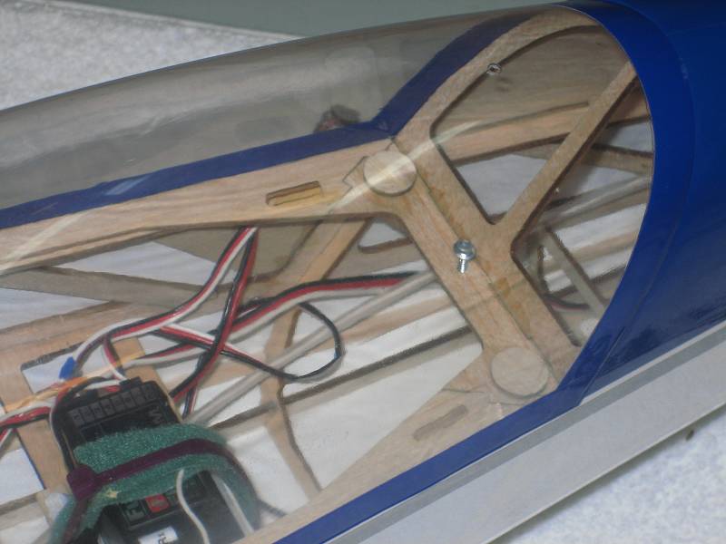

10. Canopy: I used one additional screw in the aft section of the canopy to ensure it would stay on (see pics).

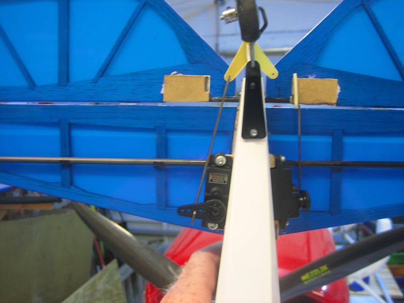

11. Stab: Noting past stab problems, I installed a small carbon tube just below the stab and simply glued it onto the bottom of the stab for stability (see pics).

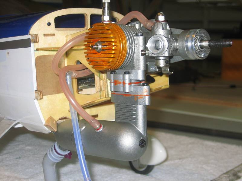

13. Engine mount: Very simple. Used simple plastice mount. Cut-off original engine box by "eyeing" it up and simply inserted new firewall. Again, very easy.

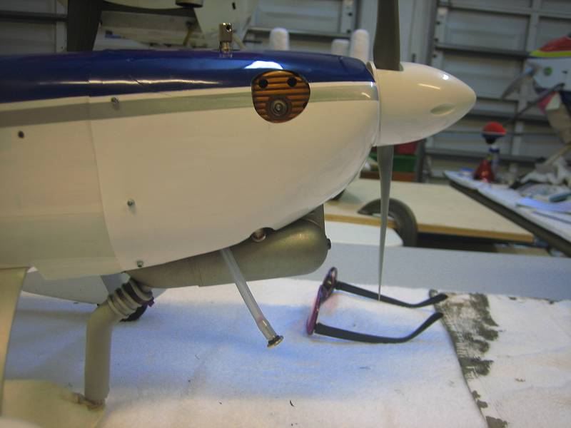

Good stuff! I'm working on a similar setup right now... using an O.S. .32 SX though. Curious, what prop are you running? And do you have any more pics of your throttle servo mount location, etc.? I've got a fairly good idea of what I want to do (to keep the CG decent), however, it's always nice to see others setups.

I'll ge another photo of the throttle later. I glued a little servo to the side of the plane and used a 1/16" steel wire. Not the lightest but effective. I used the APC 11x3 on the Mini-3D GMS .32 combo, and the APC 11x4 on the E300-G GMS .32 combo. These little .32's really sing with these props!
