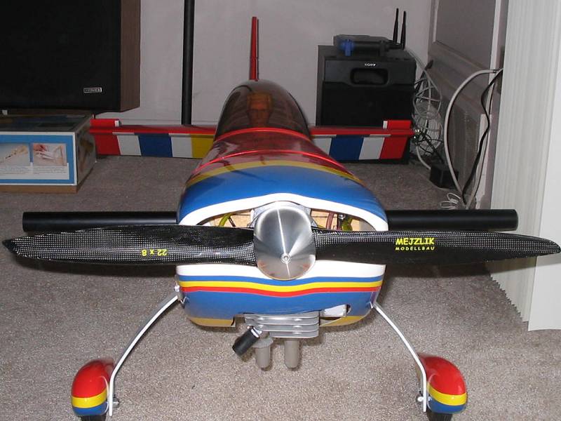

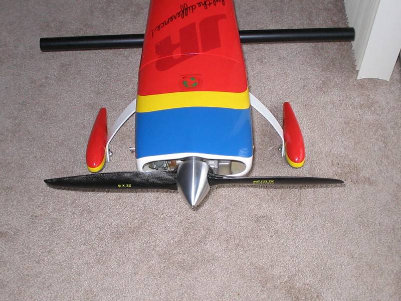

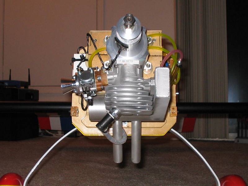

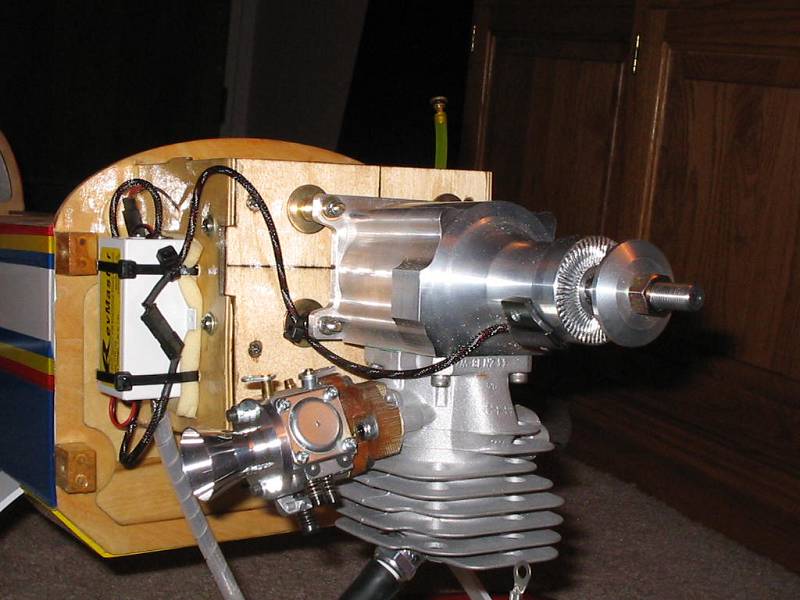

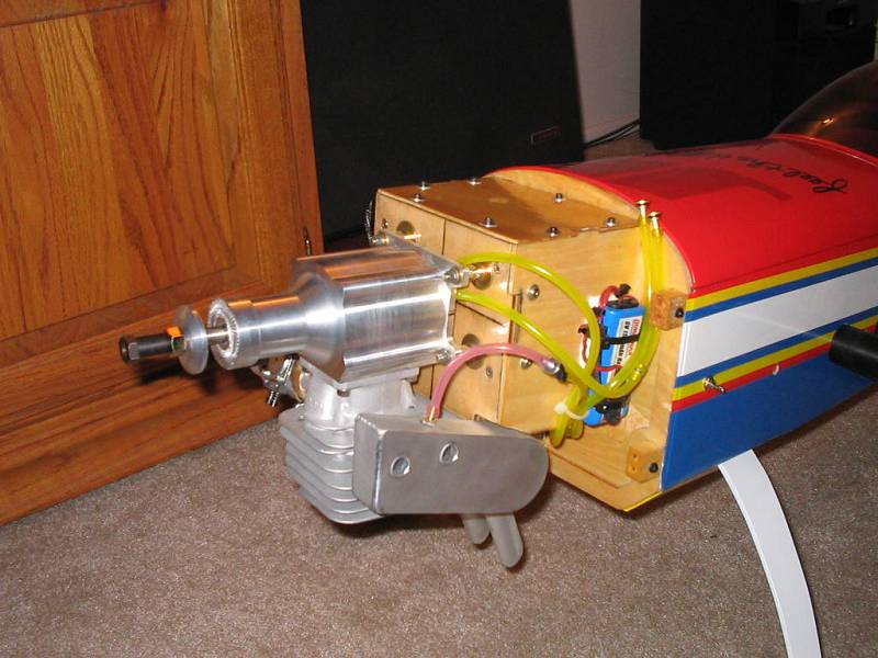

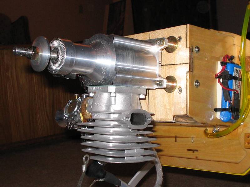

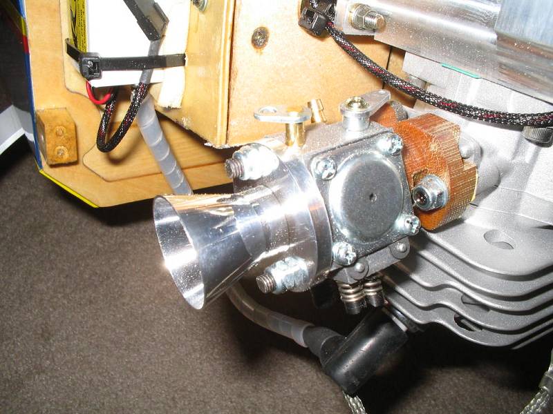

i did alot of resurch about engin choices for this plane almost everyone on here said a 50cc gas engin was too much but they all were using a fuji or a zehnoa very very heavy engins 6 lbs pluse i went with a brison 3.2 3.25 lbs half the weight of the others with a mejzlik 22-8 and the airplane flew awsome i didn't use any high rates cause it was the test flight but the performance in up lines was great i did a few imac menovers and it performed awsome tracked great and was very persice i did not do any 3d beaing it was the test flight but i think it will not have a proulbum preforming in any 3d menover i would recomend using this engin to anyone who wants to build this plane

What is the weight of the finished plane ??

the weight of the plane is 16.8 lbs wet 15.4 dry but i could shave a pound or so i i got rid of the smoke system but the smoke looks so good it is half a pound lighter than my friends hanger 9 extra 260 with the same motor amd smoke system
