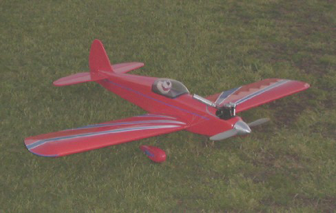

I have a 90-120 SS
Put a saito 150 runnin a 16X8 prop and it will hover at just over half throttle. Its not a 3-d machine as stated above, but it sure is alot of fun!!!!!!!!!
