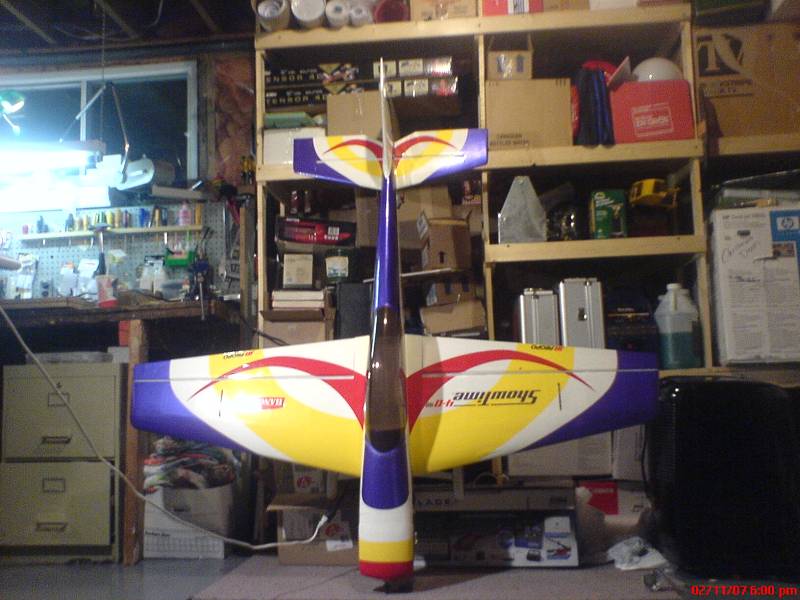

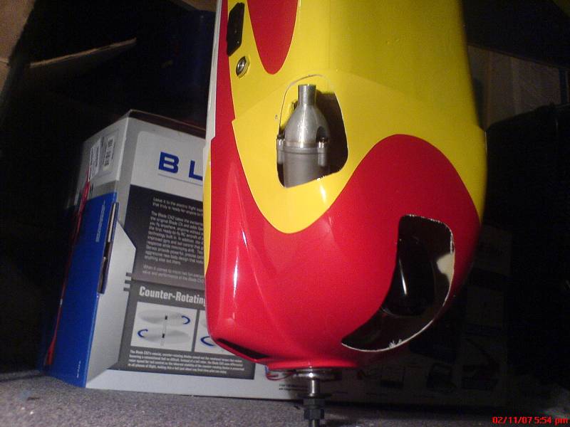

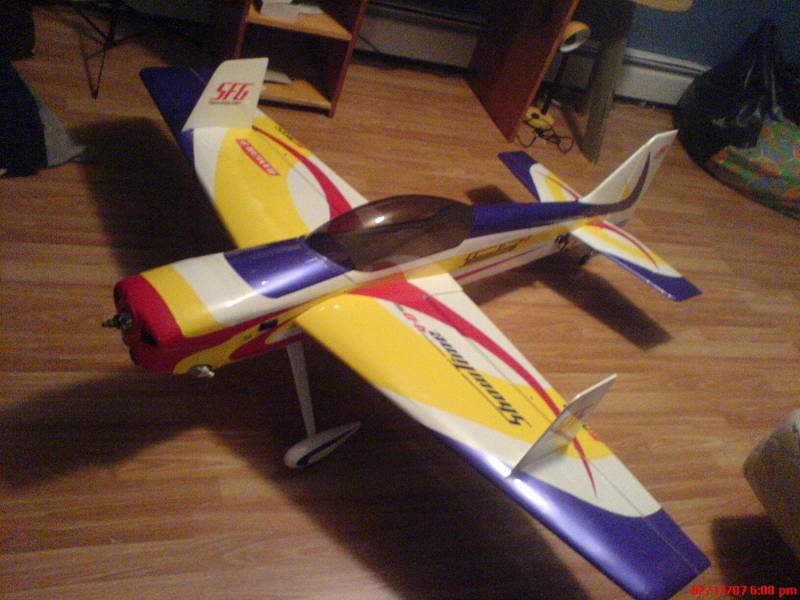

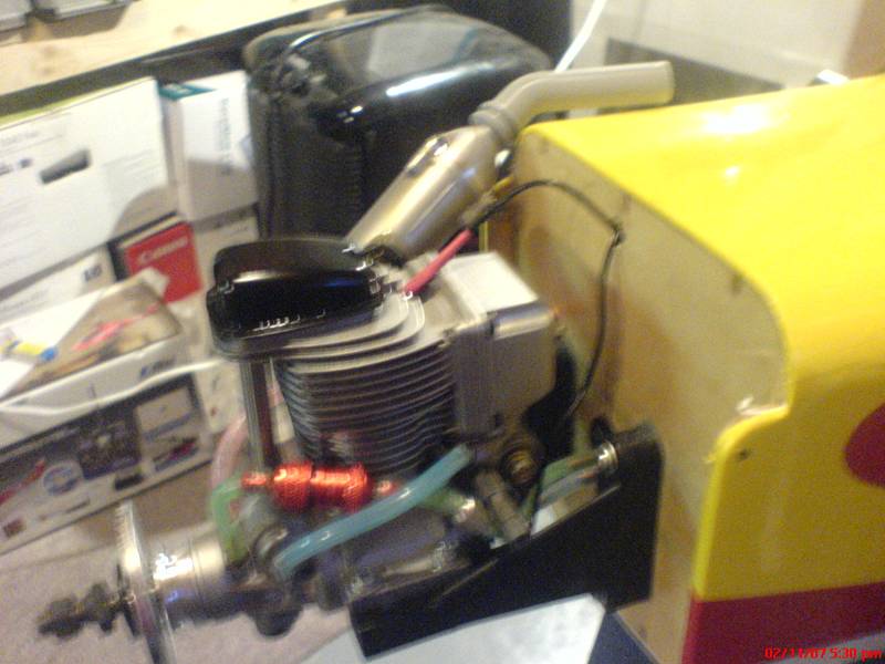

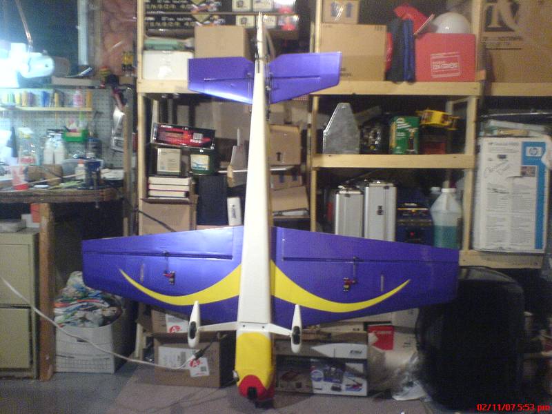

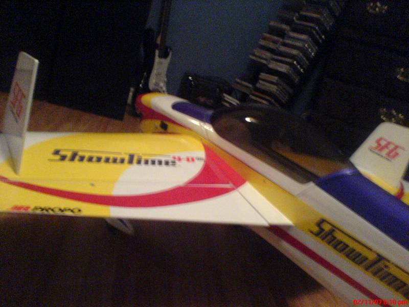

I'm just finishing up my hanger 9 showtime 4D 90. i put a ys 110 four-stroke in it for a motor and i was wondering what propeller i should put in it that would be the most aerobatic. if anyone has any ideas id appreciate it. im thinking maybe an apc 15 x 4 wide
heres some pix...took em with my phone not as clear as a digi cam but still not to bad

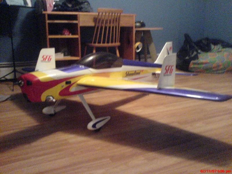

some more pix..sorry i took them with my cell phone so the quality's not perfect...

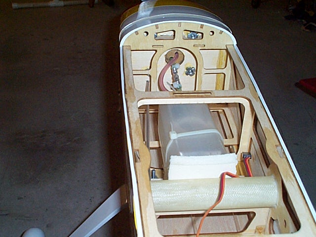

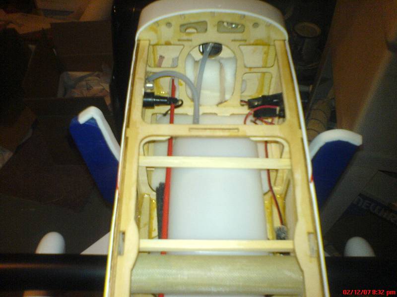

Your build is looking really good. I also have a showtime with a YS110 -- it has really good power-- I'm sure you will like it. Have you considered moving your tank back up against the wing tube? I put mine there and most of the guys with a YS in the showtime also put the tank there -- it makes the CG shift less as the fuel goes down. I'm sure, though that if you don't the Showtime will still fly well.
Old 02-12-2007 | 06:52 AM
Joined: Aug 2005
Posts: 138
From: charlottetown, PE, CANADA
Default RE: Showtime
i did think about it and i may still do it. is there any bracing you have to cut out in order for it to fit?

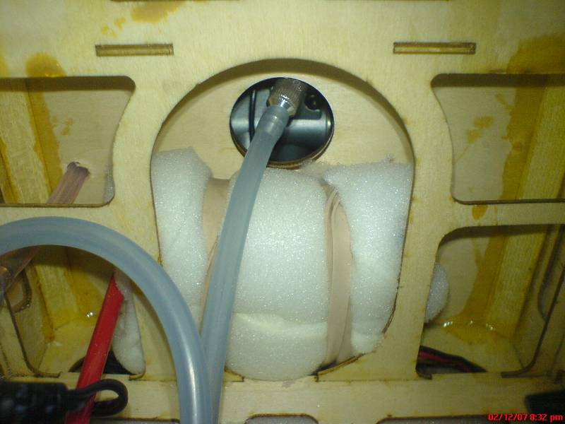

Old 02-12-2007 | 07:41 PM
Joined: Aug 2005
Posts: 138
i moved the tank back a bit. not sure if it's positioned the way the other guys do it but i needed weight up front so i put the battery in the whole where the front of the tank was supposed to go and the tank is further back. Here are the pix

I moved my tank back to the wing tube also, I only used ine piece of ply about
1" deep that fits across the fuse... I use a tetra tank that I had... Works great
