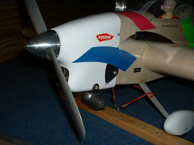

I have just about convinced myself to go with a YS.63 for my new Flip. I'd like to know how you guys are mounting them. Are they being mounted horizontally like the instructions call for or are you guys mounting them inverted? If the inverted mount works I would think that looks better?
Show some pics of your YS.63's mounted on the Flip.

Here you go.
Jim

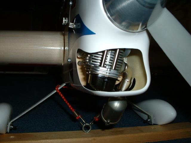

Here's a close up.
Jim

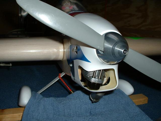

Default saito 91 on flip 3d
With the addition of an O.S. exhaust header pipe for the FS70-91S (part # 72109500) you can get the muffler to come out on the bottom of the plane. My plane stays very clean with this set-up.
Jim

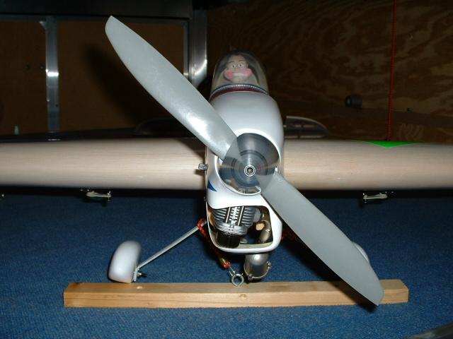

One last pic for you.
Notice that the engine is not at the 6:00 position, but at about the 6:30 or 7:00 position. This allowed for the muffler to fit in the cowl better and come out on the bottom of the plane.
Jim

Is that the ys 63 muffler then with the os header ??n Looks nice
Old 02-11-2003 | 07:10 PM
My Feedback: (309)
Posts: 1,682
From: Loveland, CO
Yes it is the YS 63 muffler with the O.S. header.
Some guys even put the O.S. muffler on the YS 63 and claim it gives them more power. I have not yet tried the O.S. muffler. I like the way this worked out with the YS muffler this time.
Jim
Old 02-11-2003 | 07:38 PM
Posts: 1,407
From: Louisville, KY
Jim, It looks as if you dont have any ground clearance with that prop? Is that the case or just an optical illusion?
And did you cut out all of that cowl for cooling or what?
I have adequate ground clearance with the 14x4 prop. I'm guessing it is about 2 inches. I could use more, but it has not been a problem so far.
I used a Hyde soft mount on my YS 63. With the soft mount I get some movement of the engine and I had to allow for this movement by cutting away the cowl.
I do get good cooling this way also, which I believe is very important on a plane that is intended for 3D flying. I'd rather have the cowl cut back and not look quite as good than burn up an engine by overheating it.
Jim
