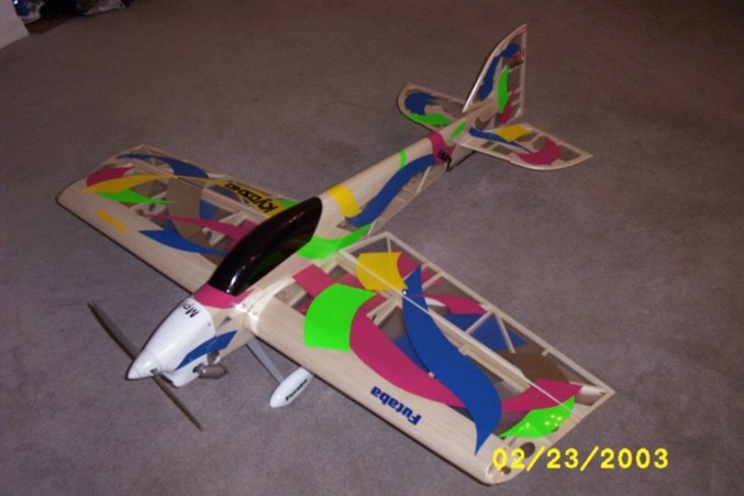

Flip is finished, fired up the ys 63 on the cool power 30% heli, 10600 rich out of the box with the apc 14x4W. Here is a pic, hope to fly soon when weather gets better
