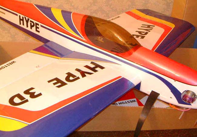

Couple of people asked me to post my experiences with the New Weston Hype 3D Original. Its not quiet ready for a test flight yet, construction so far has been dead easy with all parts fitting well.
The pics show the quality of the finish (match up of cowl, and wish I could cover like this!)
Elevator/Rudder controls are push/pull. Thought this would be a pain to fit, but found it relatively painless using a long piece of piano wire with a hook bent on the end to feed the wires through the formers.
Motor and pipe is the recomended West .50T1 and Genesis throttle pipe.
Will post some finished flying pics/movies

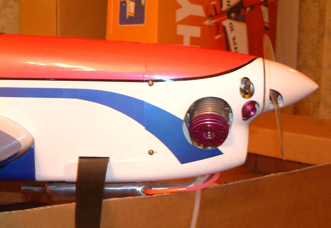

cowling finish and fit, you can completely enclose a standard exhuast.

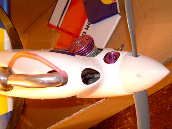

Underside or cowl

Arnie - Either you've made a damn good of cutting the cowl or it was done already ?
Is the tray fastened to the underside of the wing in the same way or has this changed ? Mine didn't match up that well and it was fairly flimsy.
Where are you putting your nicad ? On mine I put it behind the first tail former, just behind the wing TE. Had to take off the tail covering to put it in of course.

Ditchit, It comes with a clear plastic extras cowl to aid cutting the main one - makes it pretty easy. The exhuast cut out was just a bloody good guess!!
The belly pan shape fitted the wing perfectly. I just removed the film and stuck it on with thick Cyano. Dont know about the balance as I havent got that far yet....I'm hoping Sunday for a maiden flight.
