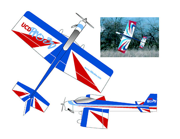

Old 03-01-2003 | 06:36 AM
mecam's Avatar
Joined: May 2002
Posts: 559
From: Airfield, CA
Default I hope he doesn't see that I posted his art work..
Old 03-01-2003 | 06:37 AM
My Feedback: (19)
Posts: 927
From: Walnut Ridge, AR
Default UCD Motor Please
Yeah, that scheme looks great!

How about a YS 110. Lighter then a YS 91, stronger then a YS 120. Can't wait! I know, you guys what to fly this plane NOW! I do like that scheme for the UCD3D.
