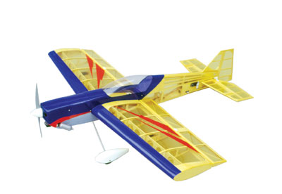

Default giles 202
what about the GSP 3D giles?
http://www.giantscaleplanes.com/Giles3D-49.htm

Old 03-05-2003 | 09:47 PM
Posts: 1,652
From: Tucson, AZ,
Default 3D plane for Webra 40
Nice!
Not sure about the weight though, they say 5-6 pounds. you probably will only have 5 pounds of static thrust from the 40. it will fly and do most aerobatics, but its really nice to have more thrust than weight. 5 pounds of thrust in a 3 pound plane has its advantages.

TooLy's Avatar
Joined: Dec 2002
Posts: 900
From: Tel Aviv, ISRAEL
Default giles
GSP wrote to me that my webra 40 is more than enough power for the giles 3d 40.
i will go on that.
thanks for your help guys

Old 03-07-2003 | 07:08 AM
Posts: 135
From: Richmond, BC,
That "GSP" giles will turn out very light. I am building one and it will tip the scales at 4.25 lbs with an OS50. Bare airframe (no engine or radio gear) is 2 lbs.
The plane is available from other sources at lower price than GSP, it is made in China and sold through many distributors.
Biggest problem with it is the tail is very light and the nose long, it will come out nose heavy.
