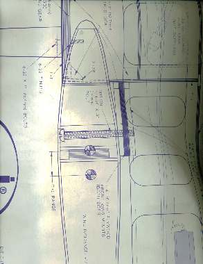

The CG is at the middle/aft of the main spar. ( 6.75" to 7'') Much farther and you will be in trobble. I flew mine at 7.5'' (for the leading edge @ root) and it started becoming harry
Happy Flying

Thanks, Ryan and Wingwiz. 6-1/4" is the aft rec. and 3/4" behind the rear edge of the spar. So, 7" is 3/4" aft of that. I usually have my CG aft (where it's supposed to be) of mfr's and most people. I like it to be hands off inverted. Sounds like it will fly at 7" but that's about 1.5" behind the spar. Anyone else?

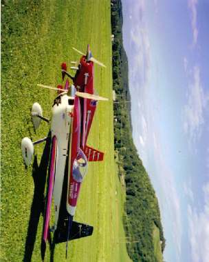

Midwest Cap 232 27%

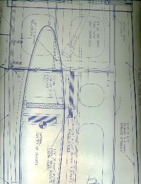

Old 03-10-2003 | 06:34 PM
Posts: 49
From: US
Default Midwest Cap CG....7"?
Midwest E300 XS 27%
