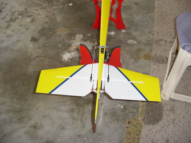

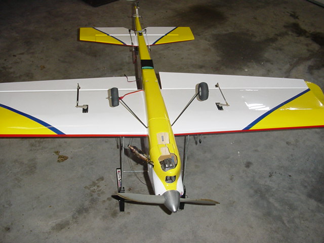

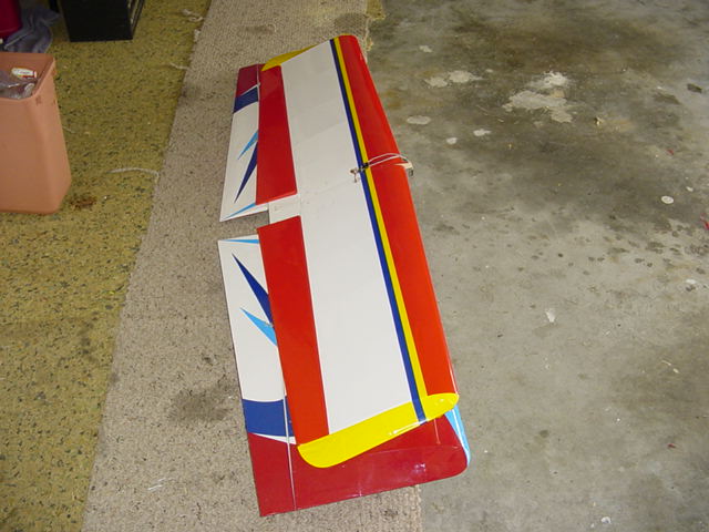

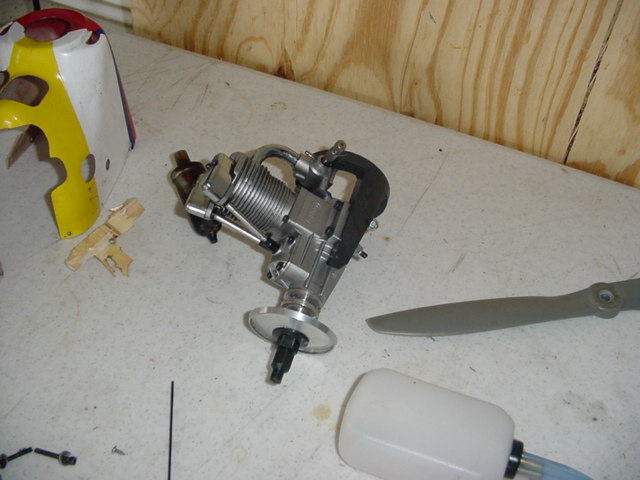

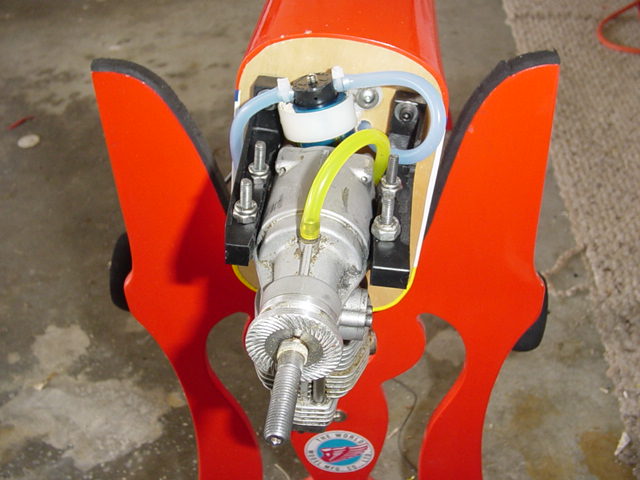

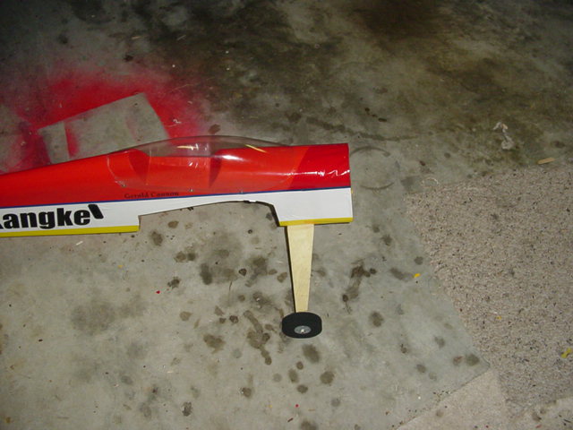

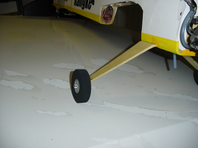

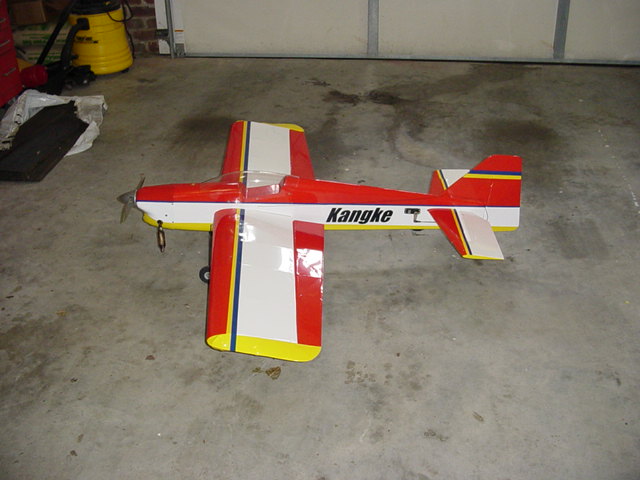

JUGFLIER
I ran out of glow fuel t-roll mine and this resulted in knocking the front end off. While it was down for repairs I changed out the landing gear best crash solution I could have had. Now that is the ticket to just swap it out from the start with a small weight increase....I ran out of gas with a Satio 100 and then also swapped the motor out to a OS-91 for better gas milage, as that light plane did not need the 100 the 91 on a 15 x 4 apc is still plenty.
talk about slow knife edge flight and out standing harriers and elevators this is it....

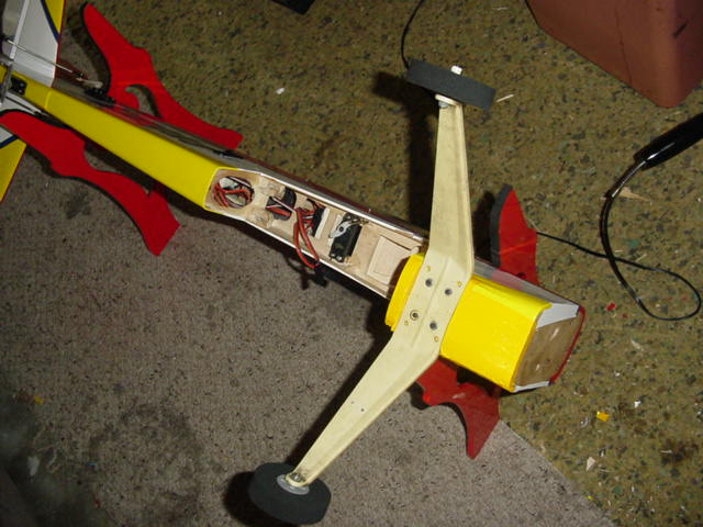

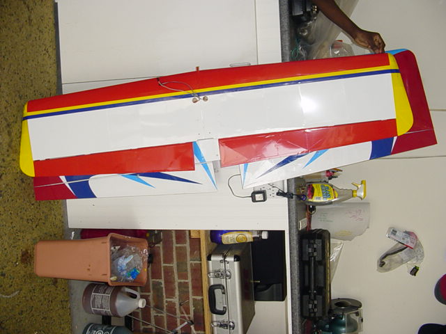

I also run each elevator on its own servo along with moving my rudder servo in the rear for balance purposes......I think I am running Jr 531 servo on there....
