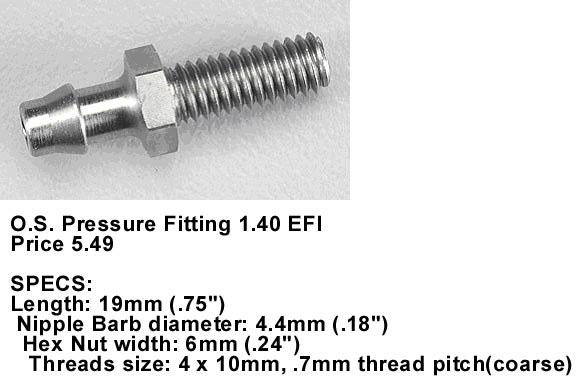

Ok I'm sold. The OS 1.60 it is (my wallet isn't fat enough for the YS 1.60DZ, but those look significant). Al, do you have a fuel pump on your 1.60 in the Cap 232? Mike reports not having one on the SU31 3D he reviewed (nice, comprehensive review by the way Mike. Man, I'll be referring to that during assembly over and over). Other threads speak to a Perry fuel pump really helping the O.S. 1.60 - particularly for 3D stuff; it seems like a non-weight issue while perhaps helping the engine?
My Feedback: (63)
50/50 Here. I would go with the perry VP30. I have 3 OS 1.60FX at the moment two with out the pump. One on the pump. Also several others with and with out.
It's my understanding the Cline regulator only regulates the pressure the needles get and it relies on muffler pressure to get it to the regulator. Where as the VP30 actually sucks the fuel from the tank and pushes it to the needle valve with out muffler pressure. I would think that if you mount the tank further back on the CG for 3D stuff you would be better off with the VP30 as it would be more consistent as it does not depend on muffler pressure in the tank.
Pat
Pat
Joined: Dec 2005
Posts: 1,166
From: Nashville,
NC
The cline uses a check valve and is tapped into the back cover I had my tank 2 feet back just to test it I ran it for a few minutes shut it down and pulled tube of the regulator it shot fuel a good 10 feet
crankcase pressure can be as high as 9 lbs thats like YS pump pressure
the best thing about the cline is no chance of flooding inverted engines like the perry will do if the tank is too high which is the case in lots of inverted engines

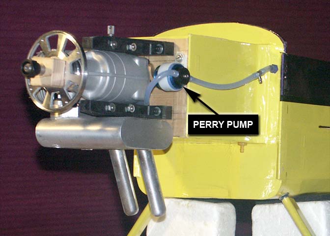

I might as well add my 2C worth since I have used a Cline/OS 1.60. The Cline is harder to install, specially if you have already mounted the engine, you have to drill & tap the back plate for a pressure tap. The Cline does work well even with a big 1.60. I used it in a 72" Goldberg Sukhoi @ 12 lbs. because the 20 Oz. tank was leaning even if just rolling the plane. I think the air bubble gets so big in a larger tank and the fuel demands of a 1.60 doesnt tolerate air in the line, just IMO. Also, I have flown the GP Yak/OS 1.60 a few times, even did a little 3-D, the 1.60 (new) seemed good enough w/o any fuel system. We had it set pretty rich but it still climbed vertical out of site & hovered for a little. I liked the way the GP Yak handled,KE all day long with little coupling. It would harrier with a little rock, but a little rudder & aileron locked it in.(APC 18X6W). The CG was 6.25", the tail surfaces were a little touchy so we dialed in some expo, it lands by itself, floats with the nose up just a little, no biggy though, hope my friend lets me fly it some more!
ORIGINAL: GO24GO
... I've tried to find some pics, but no luck thus far. Again, I'm just trying to do this right, during the winter, while I have the time.
I prefer to use the Perry VP-30 pump to take advantage of the increased power allowed by the low back pressure mufflers rather than crimping the muffler's exhaust tubes to create back pressure. The pump also allows you to place the fuel tank anywhere you want to.
The pictures show where I mounted Perry VP-30 pumps on a Giles and a Katana. One picture shows that the rear of the Giles' fuel tank extends well behind the wing tube. The remaining picture shows the O.S. 1.40 EFI pressure fitting that I use in my I.60 engines. The Perry pump comes with a little pressure fitting that you may find easier to install because you drill and tap the crankcase cover for it.

Rocketman, THANK YOU for the pics. Does the pump come with the mounting hardware? I figure it must. Is it difficult to "tap" the crankcase? Answer one question, get 2 more...
