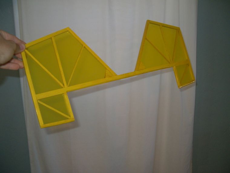

I went ahead and taped everything together to get a rough idea of how things would look. The only thing that concerned me initially was the elevator. I wasn't sure how the single piece of balsa would work out. See the pictures to understand what I'm talking about. The covering was better than I can do, so I wasn't complaing. Several years of custom design and scratch building and I still can't figure out how some of these guys do this. I can't remember for sure but I think Troy said the covering is something other than China-cote or the Cedarcote mentioned on the site. Maybe he can chime in. If not I'll ask him again the next time I see him.

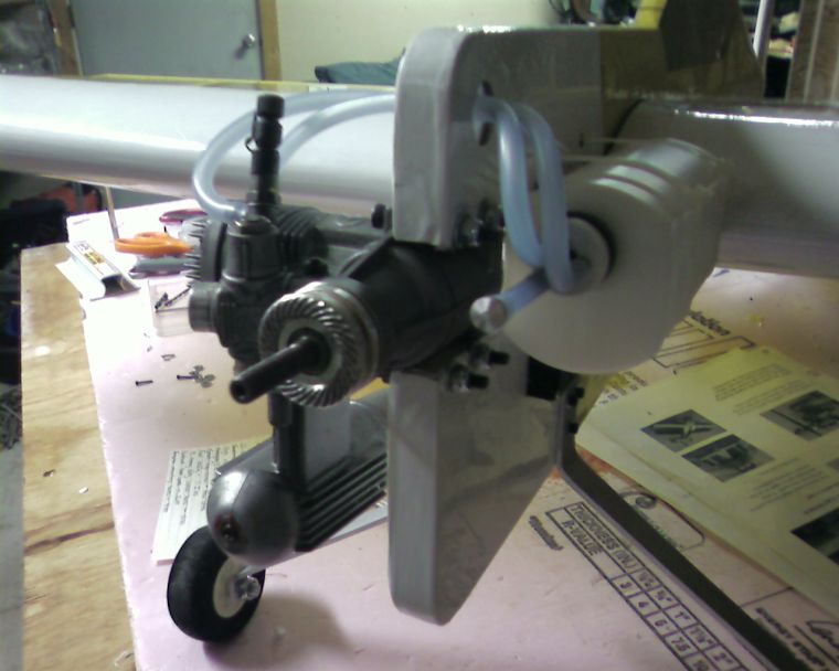

The landing gear went on easy enough. It seemed a little flimsy. I think the aluminum could be a little thicker or replaced with some type of composite gear. Nonetheless it worked out just fine initially....

Next I moved onto the tail feathers. I sorta skipped a step and intalled this before the wings. Lucky for me everything measurement wise came out ok. I did a trial fit for the horizontal stabilizer and it was off-canter a bit. I trimmed the balsa and it was snug and aligned correctly. I like to use tape to mask off where the horz. stab. meets the fuselage. This way I don't have to use a black marker and mess everything up, and so after I remove the covering to glue it in place, any extra glue goes onto the tape and not the covering job. Works very well for me.

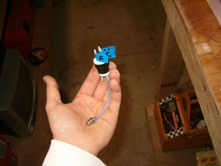

The fuel tank provided seemed good to start with. I set everything up as normal. I opted to use a different piece of fuel tubing for the clunk than the piece provided. It seemed a little small in diameter. I zip tied everything tightly and then used some masking tape to label which tube was which. Now, to jump ahead, it would be my recommedation to replace the tank assembly with a Dubro tank or something equivalent. Maybe it was me just over-doing it, but on my first engine run, the plastic backing piece that goes inside the tank cracked in three pieces when I tightened it. I didn't notice it until I had ran my first whole tank through the engine trying to tune it. No wonder I had issues, it had a vacuum leak! Check the tank!

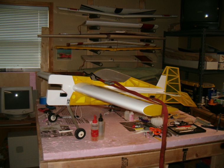

For the two other pictures above, I used a little trick. First, I setup the hardware for the tail surfaces. I used 4-40 hardware and some Heavy Duty standard, LOL, dubro control horns. You will need some extra long screws for the rudder as it is almost 1/2" thick. I set this up first to get the weight on the plane. Next, I screwed a small brass eye-bolt into the bottom of the fuselage right at the CG (CG is setup on the two wing spar halves you glued together earlier). I used this to hang the plane from upside down to help balance it from wing to wing and from engine to tail. This allowed me to place the engine in various postisions before actually mounting it. I was able to achieve a great slightly tail-heavy setup without having to add any weight.
You can see in my camera phone picture how the plance was hanging. It works! Just be sure to coat the threads on the eye-bolt with medium CA before you screw it in, just for good measure.
