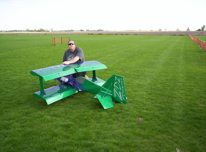

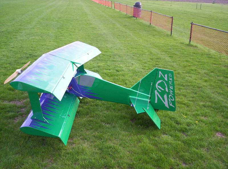

I have a problem with too light of a wing loading. The plane flies great, but with a wing loading of only 19oz, it makes it hard to land when there is a breeze. The plane won't quit flying. The last time I had it out, I had to land it elevator style. I guess it's worth putting up with though because it's such a great flyer.

Put in a mix of up aileron with a little down elevator (not always needed) and it will take the float out of the wings. Be careful though, that plane has a lot of drag. BTW the Cubic loading formula is, factor the wing area by 1.5 and divide that by the weight.

I have spoilerons set up and when I hit the switch, it goes into a harrier and stays locked in. Fool proof.
