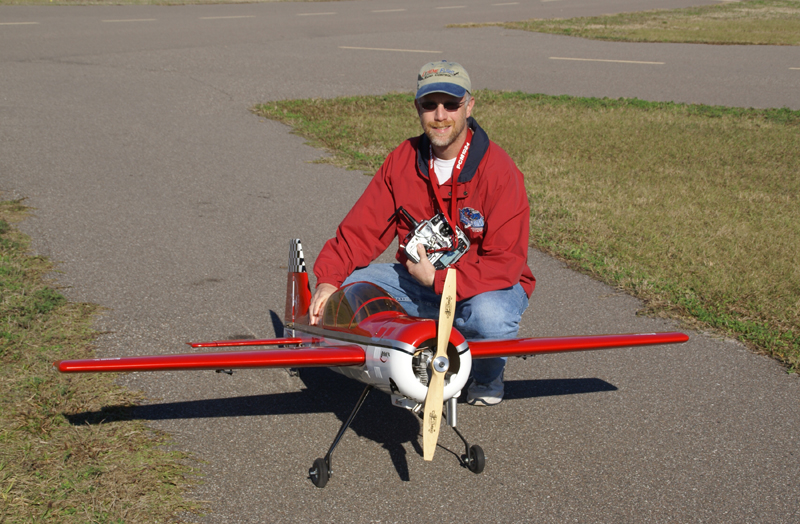

do u have any pics of your yak with that setup? did u have to add any weight to balance the plane,also what kinda battery r u usinf for ignition?
Old 01-04-2008 | 05:59 PM
BarracudaHockey's Avatar
My Feedback: (11)
Joined: Jul 2003
Posts: 28,282
Received 444 Likes on 363 Posts
From: Jacksonville, FL
Default RE: Questions on an OS 160 engine
I don't have any detailed pics but here she is.
There's a 2000mah battery up front for the ignition and a 2900mah rx pack right behind the cg, the fuel tank was moved back to the cg, weight is 12lbs 6oz zfw
As a former glider pilot, I detest adding weight to anything if I can at all avoid it.
Balance is at 6 1/2" though I probably need to move it up a bit till I get used to it.
