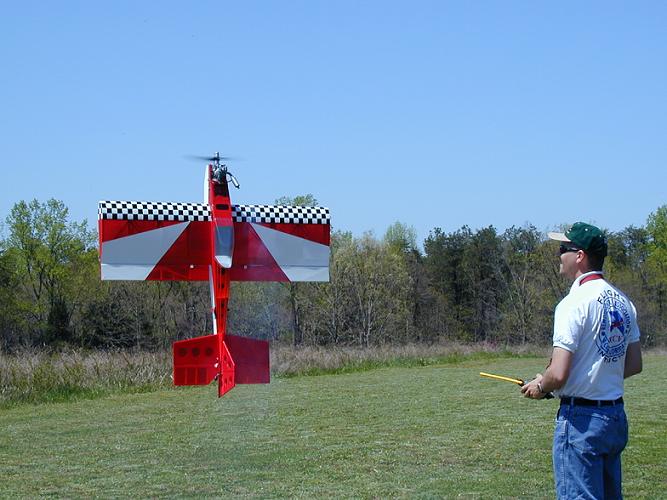

It was a nice day for hovering yesterday, and stevezero snapped a few pics of my Pizazz. It's got a Saito 91 with a MA 14x6 prop. The left stick is almost as sensitive as collective pitch on a heli.

nice!!!

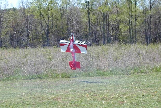

He was lower than this, but the camera lagged behind.......

looks nice. i remember the first time u were at the field with it talking about wanting to get low, looks like u finally got there. good job. i am gunna ahve to sell my pizzaz w/.91 to fund other stuff but i think they are awsome with that motor

hey wingspan, u running stock throws + expo for what they tell ya? i have a 71 OS on mine..Just learning to hover now. and thibg u do to make it better?

Is it my imagination or do you have spoilerons turned on? Does it help the hover any?

They're not really spoilerons because they don't stay up all the time, they're mixed to the elevator. They do help give additional authority to elevator inputs. Also I have ailevators where the elevator halves act like elevons. The biggest change I made was to pull out the OS 70 I had in it and put a Saito .91. The Saito weighed 1/2oz less and still fit in the same bolt holes. The change in thrust and control was remarkable. If you are struggling to hover you probably have too small an engine or too low a power/weight ratio. I think a .70 should have no more than 4.5 lbs, not 5.75 like my Pizazz.
