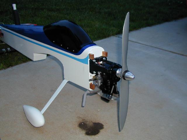

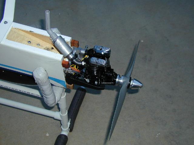

Here are a couple of shots of the saito 150 on the nose of the UCD. The cowl wraps totally around it, very clean installation. I'll try to button the cowl up and take a pic of it this afternoon. That is an APC 17/6 prop on it, and I have yet to take it over half throttle out of shear fear on the ground. LOLOL. I still have some tank issues I need to address. I am going to do the floor mod and drop the tank that people are doing in the UCD thread. Still havent flown it with this engine yet, been down at the Joe Nall (what a hoot that was)
Steve

Prop clearance is still well over 2 inches. If it sags on hard landings, then it will get a spreader bar, or carbon gear. I will weigh everything and compare it to the weight of the 91 fx. It balances laterally much better (had to put a bunch of lead on the right wingtip to balance it due to the os muffler). A 5 cell 1000 mah nimh battery pack is resting just forward of the rear servos. Might not have to add any lead at all to the fuse (maybe 1/2 - 1 oz) I wish I would have gone with standard size servos instead of the minis on the elevators, would have given me the extra weight without all the cutting and gluing to hold the 225's.

Make sure you have enough openings in the cowl to let the air out. With the muffler blocking the main outlet like that you might not have enough cooling air flow.

I've got plenty of openings in the cowl. Both cheeks are open to cool the case, and I have a large opening at the bottom of the cowl, and at the bottom front of the cowl to cool the head. There is still alot of room for air to pass over and exit down the bottom.
