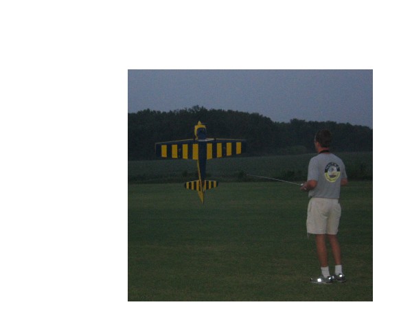

Finally finished my GP Cap 232 with a OS 50 Sx and it is a 3D monster, it fly's just like a 40%er. just a little more sensitive and has tons of power. More pic's to follow. Ricky

citation X, what was your final weight? Nearly finished mine, but didn't try to take out any excess weight, so may regret that.
Old 07-28-2003 | 09:45 PM
citation X's Avatar
Posts: 228
From: Arlington, TN
Default Great Planes 40 Cap 232. Will it 3D?
Sprink-My cap came out at 5 1/2 Lbs with 5 mini servo's and a AAA 720Mah battery pack, I also ditched that 3 piece junk cowl with a fiberglass cowl from Stan's fiber tech. Ricky

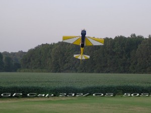

Default Belly Shot
Here is a pick of the bottom! Ricky

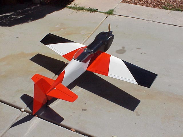

I have the GP Cap with an OS 70 in it. I would reccomend the APC 13X6 Prop for that plane. You will end up with tons of power and great vertical. The best motor for the plane is the OS .91 Surpass II. It has the same weight as the .70 +- a tiny bit and fits perfectly. A friend of mine went with the .91 combo and it is great. I did all the maiden flight stuff for him and found it much more enjoyable to fly than with the .70. His goes straight up with power to spare. His has an APC 15X6 prop and it turns that great. Dont under prop a 4 stroke! Very bad! Go with the 13X6 if you already have the .70. Should turn it at about 10K on 15% fuel.
Good Luck, Phil (Mesa, AZ)
By the way, mine came in at 5.5 LBS with the OS .70 Surpass II and NO modifications.

Default Here is another pic
Here is my friends getting ready for the maiden. OS .91 Surpass II. Perfect powerplant for this plane! DO NOT put a little 2 stoke in this plane. It really deserves a .70 -.91 4 stroke. JMHO
Phil (Mesa, AZ)
