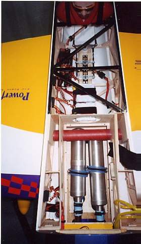

But, in case my opinion is biased..... do the math. With 1427 Sqin of wing you could be at 17 pounds and still have a lighter wing loading than anything else thats out there now thats in the 25 to 30% class.
Old 05-15-2003 | 11:31 PM
Posts: 135
From: Round Rock, TX
Default Wingload for 3D flying
How are those "extreme flight" planes built? I cant see how they can get the plane to bee so light without coming apart. I mean some of these planes that are not all routed out and lightened have some structural problems.
Those #'s are hard to believe. I had a 30% cap with 1400 sqin wing that weighed around 23lbs.
It will certainly be interesting to see how they hold up under everyday use. The only way to make it lighter is to reduce the structure somewhere and that could potentially reduce the strength too, if not done properly.
Plus I don't like the bottom of the canopy how it is an open cross brace design. Obviously done to reduce weight, but it just doesn't look right. How do you go mounting an instrument panel and pilot as required for IMAC?
Same as you do with the DP Extra and Edge.
Old 05-16-2003 | 05:48 PM
Posts: 6,378
From: Bloomington, IL
