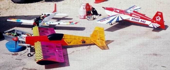

I just bought a seagull razzle. I have a Super Tigre s- 75k that I need a home for. Will it pull the razzle around with authority? If so, what prop would you suggest for 3d.
Ryan

I am currently getting my Razzle ironed out. I have the ST 60 in mine. It will hover just below full throttle so you should be O.K.. There is a thread on this aircraft and some suggested mods to the tail section. Also I had the aileron control horn area start to get mushy on mine so I am adding some 1/64 ply to reinforce.
Try a 14-4 APC, I had that on my 60 and will be going to try a 12-6 or 13-4 to get some RPMs back.
Have fun
V-Snap
The plane flies good, lands like a feather, just takes time to get it balanced.

hi, the razzle is a great flier we had a saito 91 in ours and it flew fine but it needed more so we now run it with a 91fx with unbelievable oomph a14x6 will take it to the moon. don't forget these planes are soft because they are built so light. i read some where that these new super light fun fliers are built for flight and not for crashing.
do strengthen the tail!!
we also modified our wings and she now harriers and rolls much better.l
