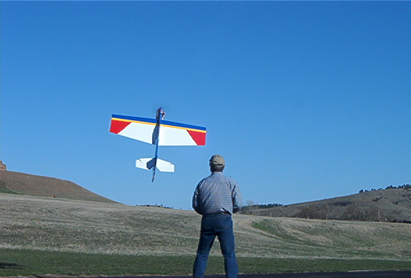

Every body has a certain flying style, some like a quick spool up some don't, some like to fly with a lot of breaking action in the down line, some don't some like the higher torque achieved by using larger Dia. low pitch props,some don't other things that dictate prop selection, weight of the plane, parasitic drag on airframe air foil of the wing etc etc. IMO you can't beat this combo (OS 91 FX and a APC 15X4W) for 3D flying with the U CAN DO 3D. You can talk to 10 different guys and they might all have a different setup. That is what I like, Individualality. Ahh the good old US of A Picture is of an OMP Kit Built 65" Yak 54 OS 91 with a
15X4W APC
jerrysu29 Call Sign Wild Man HAPPY HOLIDYAS TO ALL

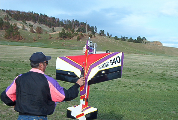

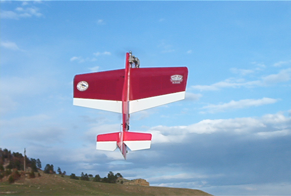

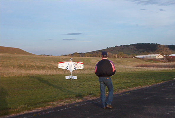

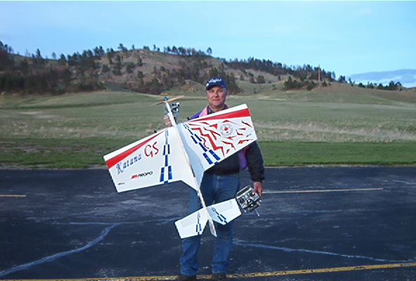

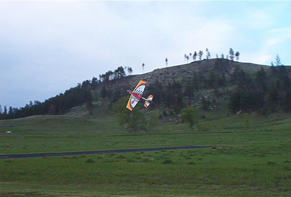

One other thing to Ponder. Keep the overall weight of RTF plane to a minamum. All my Profiles over 7lb. I run the OS 120 2cyl.
The OMP kit built Yak54 RTF weight was 7lbs. 2oz( OS 91FX APC 15X4W) The New ARF OMP 65" 55-SP Yak RTF weight came out at 8lbs. 4oz so it received an (OS 120 2cyl. APC 16.5X5W) both sport stock mufflers. IMHO a stock muffler works the best for 3D.The Ultra Thrust mufflers such as the one from jett enginering is designed for racing (TOP END power and do not transition well when hovering) one thing I do not like is a plane that will only hover just under full power. I like a plane I can tail slide in from 20 feet at a good decent and stop the tail slide where and when I want. This requires a very high power to weight ratio of at least (2 to1) another thing I like to do is start at one end of the runway at about 30 feet in knife edge. drop to 2 feet and fly down the center line of the entire length of the runway, high alpha knife edge all the way The main thing is to get out and fly, fly, fly and experiment, experiment experiment OOH YEH remember Altitude is your friend when doing these things. LOL!!! P.S. The Goldberg Extreme 540 Extra 47" pictured here has an OS 91 FX (APC 15X4W) on it, theplane is in take off mode, the other is a 47" MVVS, SU-DO-KHOI with an OS 61 FX (APC 13X4W) Accel Katana Saito FA 72a (Zingar 14X4)
