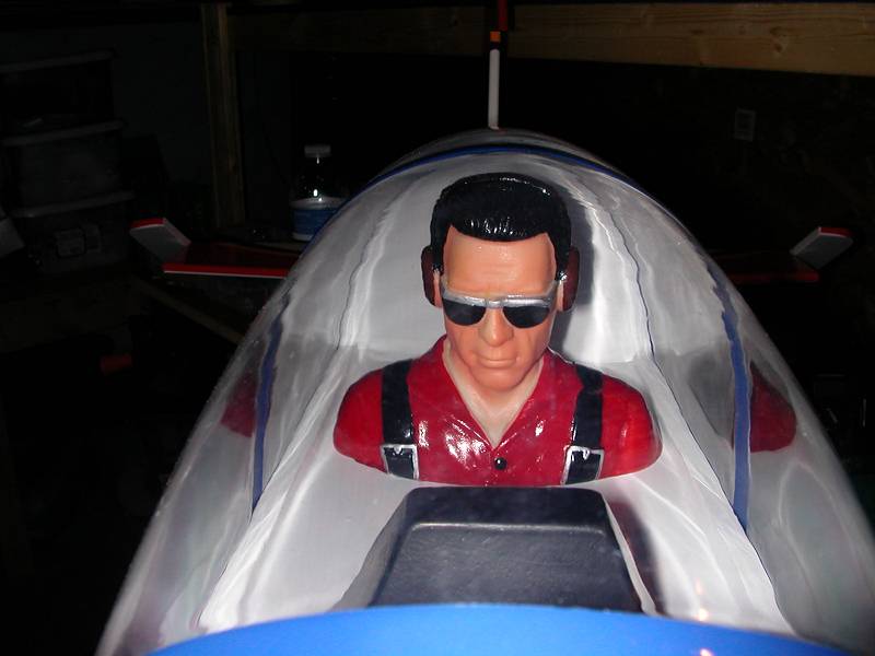

Default RE: witch Engine should I use?
Here are some pics of it so far.
