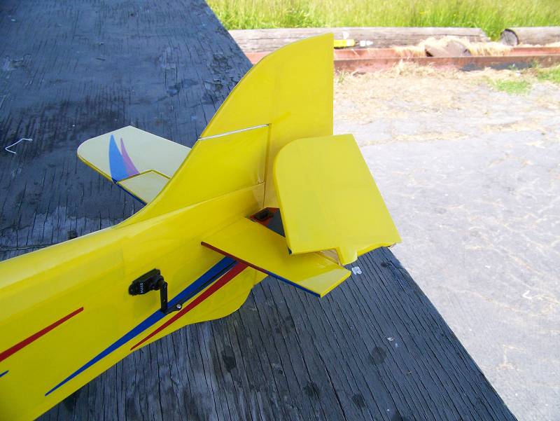

I flew my Great Planes Reactor 3D EP Performance Series today on its first flight. I took off, flew to altiude, turned to low rates, trimed the plane out, and then flew an emmelman at about half power. I heard a crack and the plane was no longer in trim. I slowed down to land and overshot the field as I was stunned to see what had happened. I went around again and gently landed. The elevator had factured in two! This plane has about two to three minutes of flight time. It had a structural failure at slow speed, half throttle, without any sign of flutter prior to the failure. It is very clear that there is either a design or construction flaw. Have other people had this type of failure? Is this plane fundamentally flawed or is there a retrofit to strengthen the elevator?
ID:	1200824   Click image for larger version

i would love to see a pic of the elevator without covering on.  to me it looks to be either a design flaw or material used flaw,    the leading edge of the elevators are no doubt constructed from balsa where i would say they should be made with something like spruce or such.   thats not good for Great Planes Manufacturing.

Potentially it might be weak, flutter and keraaaacccck ...

Have other people seen this type of failure in this plane? Should I just replace it with a solid elevator?

I have the bigger brother .46 size but I have not seen anything like this before. Sounds to me like a flaw in the material. I would contact Great Planes about this problem and discuss it with them. Also I would call whoever you bought it from (Tower?) and talk to them as well. I am sure a fairlue like this is uncommon and it would be in the best interest of GP to replace this component for you.

Probably a defect in the balsa, or could have been caused by a defective glue joint, the bad glue joint causing excessive flex which could cause the elevator to buckle. Certainly an unusual problem! Contact the manufacturer, Great Planes, they should be able to do something about that.

The balsa broke mid span. It was not a glue joint that failed. I did not hear any flutter. The wind was zero MPH. The airspeed was low. Power settings low. I was in a low speed manuver. I think the elevator is not up to the loads.

it kinda looks like it broke where the hinge is installed which makes sense since that is where a stress riser would be.  So a hole in an unfortuanely picked piece of balsa and snap, broke at the weak spot.  Probably just bad luck.
Honestly, I would just re-do that side of thr elevator and not bother calling GP, after all whats the best outcome for that?  They give you a new piece and its actually more work installing the new piece than it is fixing it withou the free piece right?

So, I contacted Tower Hobbies and they shipped a replacement tail. I replaced the elevator. I then tested the servo and found the elevator servo gears had been damaged so I replaced the elevator servo as well. I then went out to test the plane. I flew around on half power just enough to maintain altitude. I did a split S into the wind. The elevator fluttered, broke, and the plane was destroyed on "landing". I think the Reactor EP is sensitive to elevator flutter. The design is defective. I am shipping the carcass of the plane to Tower Hobbies for evaluation but this is absurdly poor design. [img][/img]

SImple question for you. Was the elevator hinge line tight and sealed? I looked at your original pics and it looks like you have high quality linkages installed so you can rule that out.

The hinge didn't fail until the plane hit the asphalt runway. The hinge line was not sealed. That is an interesting wrinkle to this problem. The instructions do not mention sealing the hinge line. I have done it on some planes but not on all. I think, the issue is the "balance" surfaces on the elevator. The "balanced" elevator tabs must place to high torsional load on the elevator and horizontal stabilizer. The elevator starts to oscillate and has a resonance frequency that is too low. On the first flight the elevator fractured. On the second flight the horizontal stabilizer fractured. The design of the elevator and horizontal stabilizer is too light to prevent flutter, oscillation, and immediate fracture. I was stunned that there was absolutely no warning of flutter. The elevator simply fluttered and immediately failed. The entire failure took less than a second. Moreover, the plane was at extremely low speed. Control surface flutter can be a problem at high speed and is part of the reason for a Vne in full size aircraft. In this aircraft, the Vne is less than 10 mph. I think it just turned into the wind, fluttered, and failed.

I think the elevator is simply not strong enough for the loads. They want it extremely light which makes it delicate. Flying wires might help for the horizontal stabilizer but not the elevator itself. The simple fact that this plane had the same problem with two separate elevators on two first flights implies a design flaw. I could see this happening after some wear and tear or with severe manuevers or high speed. It failed on extremely cautious first flight at very low speeds. I didn't even get a chance to try a 3D maneuver, this was simply a split S at a throttle setting that barely turned on the motor.
