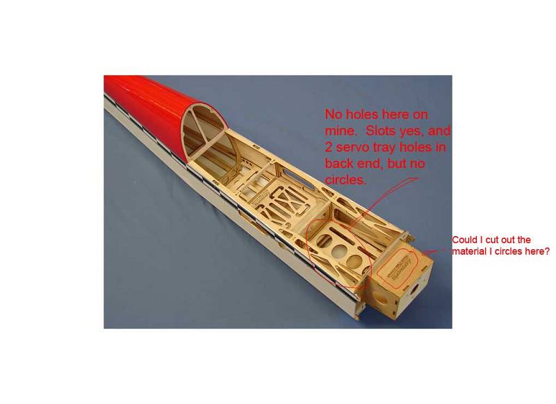

So in the photo here http://www.aero-works.net/store/imag...60_large25.jpg
there are holes cut in the bottom panel just behind the firewall. My plane doesn't have them (just 2 servo holes in the back end, which aren't shown on this one...weird) do you think it would be worth cutting them out.
How much weight do you think you'd save?

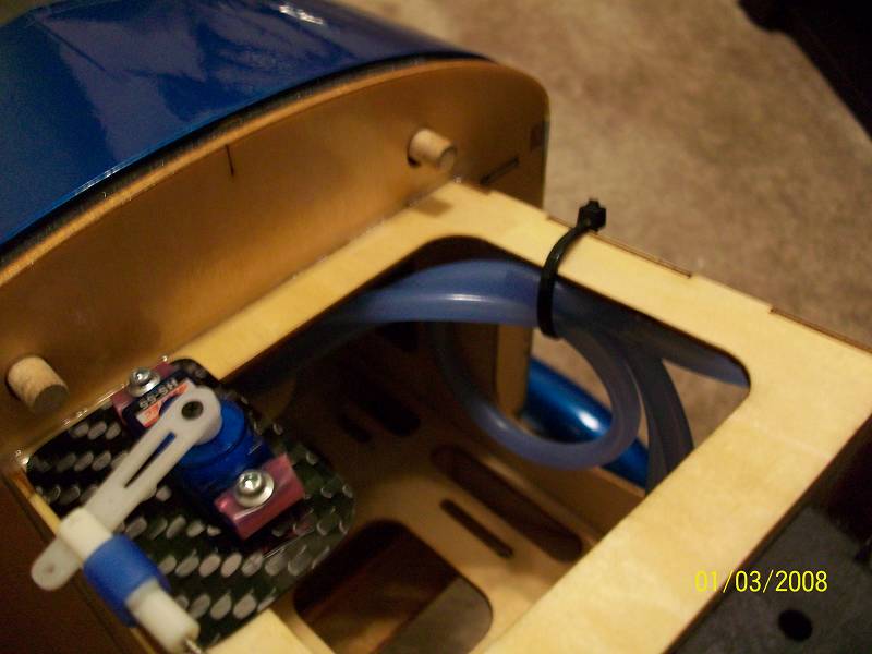

what if I were to also cut a hole in the mount box like in the photo here. I've seen other planes that have had this done.

I am always going to extreme measures to make my aircraft light. here are some steps that work for me.
I always try to use carbon fiber wing tube and landing gear. Search http://www.graphtechrc.com/ I am sure they will have something you can use.
I refuse to fly an airplane with no spinner and prop just to save weight. I have my limits lol
I have cut lightening holes in the bottom of the wheel pants to save a few grahms
Also have run some caron fiber spinners, but I have not been able to find a spinner for the .40-1.20 size aircraft. Basicaly nothing from 2"- 3" So i have some success with electric spinners. They are a little lighter than the standard ones
Cut all bolts to lengh. For example, on motor mounts, cut any excess bolt that pertrudes past the blind nut. Do it for all bolts
I Strongly recomend you DO NOT try to shed weight from wings or tail surfaces. This is what takes the stress of all those violent 3d manuvers. I have had wings break in the air from blenders on my funtana 40
Remove as much material as you can "safely" from the hatch canopy area.
The axles that come with most ARF's are heavy. I use a bolt and 2 nuts and nylon spacer to get the wheel in correct position. no wheel collars. YOu can get this at hardware store. Just think light as you are making selection
For tail wheel I don't use wheel collar to retain wheel. come times I use small washer and solder. or CA a nylon retainer on it
You can also use kevlar cable for pull pull cable on rudder. I tie it in a knot directly on servo horn and use heat shrink to cover knots. and on the rudder end I do the same on the adjustable clevis. So adjustments for tension are made at rudder control horn.
Flighton makes some very light aluminum control horns or you can use the fiberglass control horns as with extreme flight
As far as electronics, Go with the lightest servos you can find that will give enough speed and torque.
For the fuel tank I do 3 line system. but one clunk. I just bend aluminum tubing down for fill and drain. And I dont use brass tubing. it is heavier
my suggestion is hs5245mg on ail and elev hs5645mg rudder And I have had good success with hs55 for throttle just make sure you use a soft mount for the throttle servo to minimise vibration. Two ways i do it is.
three layers of double stick tape and a zip tie
slice a piece of fuel tubing put it over the mounting tabs. run a srew through the top of the fuel tubing into the servo tab through the bottom of fuel tubing and into your wood.
use lipo batteries. for this size you can use 2cell 800mah and 6 volt mpi regulator
I get about 5 hard flights and I recharge. this pack will charge quickly at field
I have done a lot of other crazy things to save weight. like using plastic soda bottles for fuel tanks and nylon bolts but for me it is fun to try and learn new ways to make good planes fly better.
If you need any photos of some the things i described I can send.
Hope it helps

Thanks! I did'nt really see any areas I could save weight in the hatch. It's 4.5oz I think, but it's fiberglass and has ligheting holes cut in it already. I'm afraid if I go more it will break from vibration alone
here's their photos online of it
and the canopy/hatch itself
http://www.aero-works.net/store/imag...60_large22.jpg
any ideas? I'm only using the left side of the middle hatch area to secure my reciever. I could cut out a hole on the right (since my battery is in back)
I'm looking forward to flying it and seeing if it will 3d better now
Thanks for your help again.
