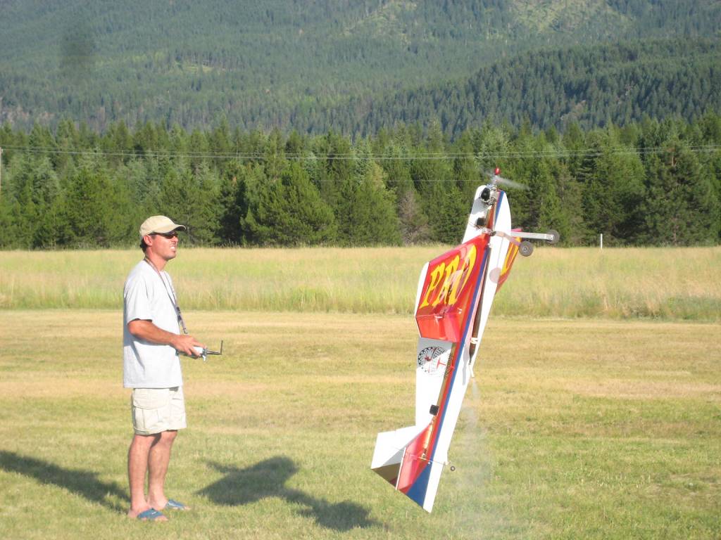

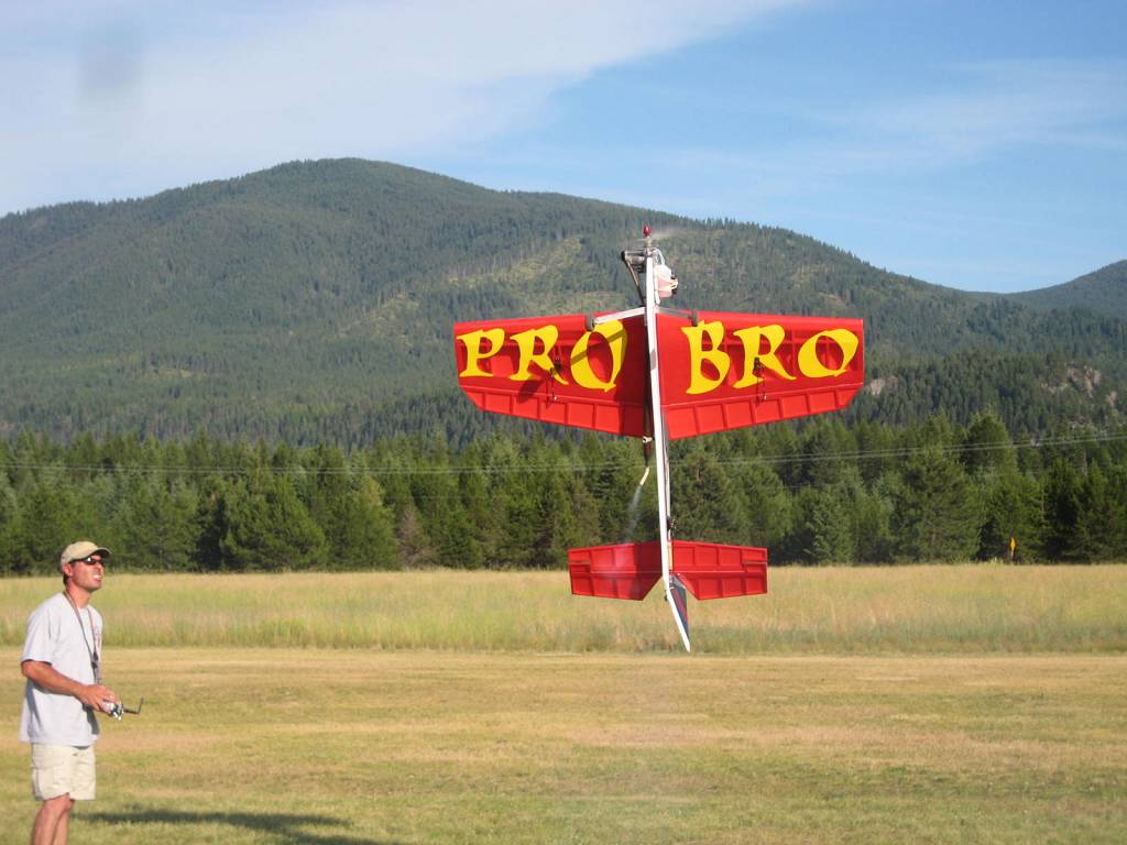

Well, You asked for the best plane for 3D, that will be a Primo 60, Slide 58, or MoAss 60.

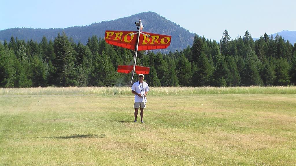

Few more of my MoAss 65
