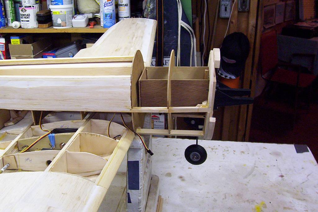

i cant use a longer nose gear.
i tried a 80 4 stroke and it didnt have enough omf.
hang in there and ill sent some pix and you can see why.
i think a 12x10 apc 2 blade would do the trick.
what do you think.
tc
frank

Its hard to tell anything from that pic, but I see that you have a tricycle gear setup. Post more pics, but couldnt you convert it to a tail dragger. And Im not sure if a 12x10 will do it or not, you will just have to try it I guess.
