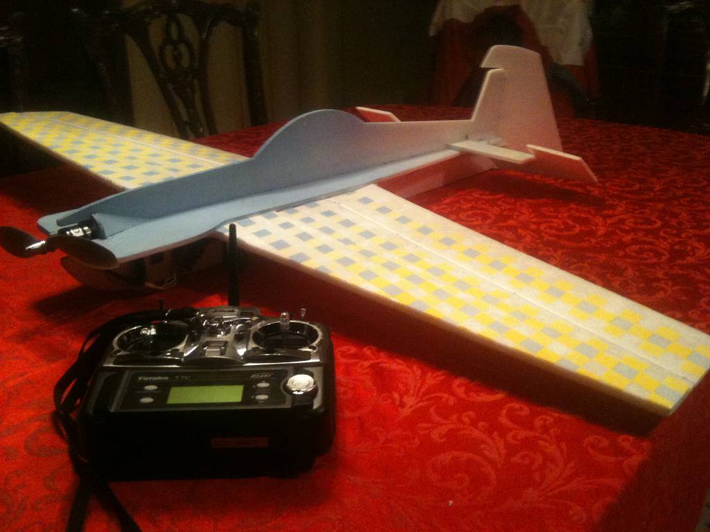

Here's a picture of the first step of my paint job.

Sure thing! I've flown it maybe 6 times so far. I'll be finishing and posting pictures of the paint job tonight. It flies great! I've got my radio programmed for snap rolls and dual rates for it. - I'm also going to be experimenting with flaperon mixes and Elev&gt;Flap mixes to see what kind of performance I can get out of it (I'll be experimenting "a few mistakes high" when I do so). Once I'm comfortable enough with it to show RCU, I'll post a video.
Here are my specs:
<span style="color: rgb(0, 0, 0); ">Motor: GForce E400 Brushless Outrunner Motor (2815-1200KV)
ESC: Hobbywing Pentium 30A Brushless ESC
Battery: GForce 30C 1300mAh 3S 11.1V LiPO
Servos: 4 -TowerPro MG90S Metal Gear Micro/Mini Servos (13.4g, 31oz/in</span><span style="font-family: Arial; "><span style="color: rgb(0, 0, 0); ">)</span></span><span style="color: rgb(0, 0, 0); ">
Prop: EMP Neodym 11 X 4.7 Electric Slow Flyer Prop
Receiver: Futaba R617FS
Radio: Futaba 7C
I'll also be experimenting with a 9 X 6 slow flyer prop. Any suggestions for improvement to my setup?<br type="_moz" /></span>

Paint Job Part 2 Done - second half of checkers plus blue fuse and wing checkers.
Part 3 to be Completed - second half of blue checkers , yellow checkers on tail, red stripes on underside of wings parallel to fuselage.
