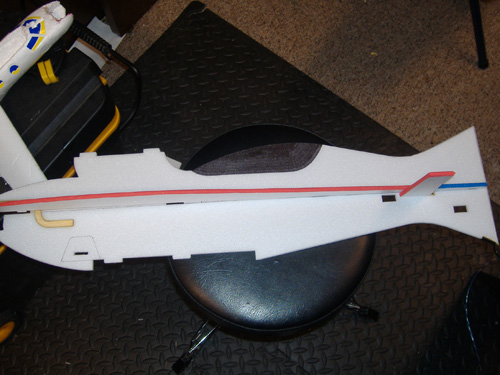

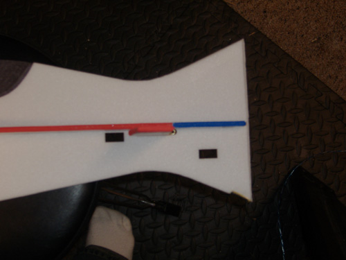

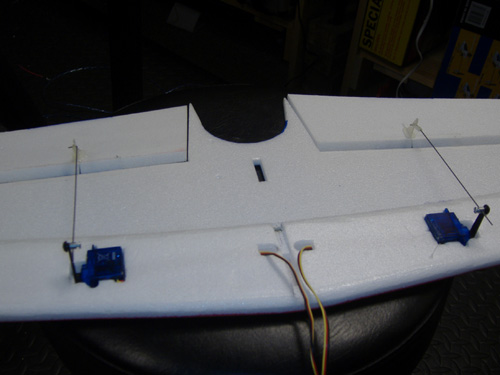

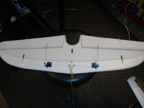

ok i looked around the forums here on rcu, but i still cant really find an answer. Im almost positive this is a 3dfoamy.com kit because the plans match to the pieces. but i cant figure out a few things. (i didnt buy this, my dad did and i dont think he bought this straight from 3dfoamy.com) so i dont have any of the extra hardware that usually comes with the kit. but my concern is with the servos for the rudder and elevator. exactly which one goes where? as you can see in the pictures this is lasercut. but wont the back servo get hit by the elevator with the elevator down? just how should this be setup. i want to set this up light and full 3d capable and i want to hopefully use this for practicing routines.
first 2 pictures are of the top wing, and how i have it setup. the last 2 are focusing on the fuse. (nothing is glued on the fuse except the motor mount...)

Hi, that has to be one of my kits with that motor mount and GForce wing.. The hole in front of the elevator is the elevator servo, other one for rudder.. the elevator should be able to clear the servo fine. Have you test fitted the elevators yet and tried it?

use a large servo wheel, or make a lite ply disc and glue it into the nose.
