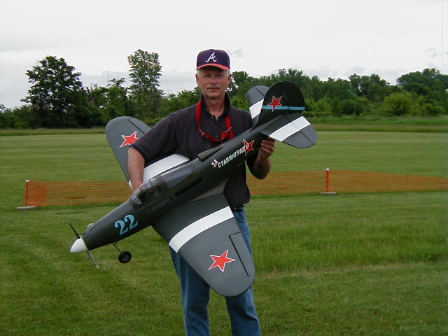

Adding a picture of my P-39, done in much the same manner as the Spit. Only difference is that the P-39 is all flat Monokote, no paint (except for the ABS parts). Flies like a trainer...only a little faster.
