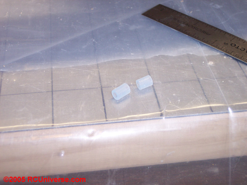

As I promised yesterday night, I'm on the road to Toledo and I'm sitting at the airport waiting to board my first flight. So it's a good time to sit and work on this thread some more. In the last post we go the aileron servo installed in the wing, so next we're going to work on setting up and installing the hardware for the ailerons.
With the servo installed we now need to get the torque rods setup and installed. The first thing that we need to so it install the install the two connectors on to the threaded portion of the torque rods. Installing them is pretty straight forward in that all you need to do is screw them onto the threaded portion of the rods (pictures #1 and #2). You will need to be a little cautious as you screw these on because they are a soft nylon and it's possible to cross thread them if you try to put them on at an angle as you start to turn them. The manual tells us to screw them on until they are 1/8” from the top of the torque rods (picture #3 and #4). Try to make sure the both connectors are the same distance from the bottom of the rods. Yes, I said the bottom of the rods. The reason for that is because sometimes the actual length of the threaded portion of the rods can be a little different. If you measure from the top of the rod when installing them you can wind up with a little bit different geometry in the throw for these rods, which can cause the ailerons to move a little bit differently from each other. If you make sure that the distance of the actual throw is the same for each rod then both servos will move the same amount as each other. While these kinds of measurements aren't absolutely necessary to fly the plane, taking a few extra minutes to make sure details such as this are correct can save you tons of time if you ever have to troubleshoot problems in the way the plane flies. I sound a bit like my drill sergeant that I had in basic training but the saying “attention to detail” really does pay off in the long run. If you spend the extra time to ensure that your plane is properly set up you will be rewarded with a better flying plane in the long run, and on the other hand if you rush through your setup and miss details such as this you will have a plane that has “quirky” flying habits. In picture #5 you can see the stock connecting rods that come with the LT-40 kit. We'll use these to construct our connecting rods for the ailerons. You'll notice that one end of the rods is already threaded while the other end of the rod is not. We'll use threaded end of the rod to screw on a nylon clevis which will be attached to the connectors we just installed on the aileron torque rods. The other end of the rods isn't threaded which leaves us several options for how we can connect it to the aileron servo. As I said in an earlier post I don't like to use EZ Connectors on a critical control surface such as the ailerons. These leaves us 3 possibilities of connectors which are Z-bends, L-bends, and a solder clevis. Probably the most common would be to put a Z-bend in the rod and connect that to the servo. This type of connection is probably the most used and can be the best all around type to use. The reason for that is because it's fairly easy to make a Z-bend and unless the servo control arm breaks there is no possible way that it can disconnect from the control arm. The next type of connection would be an L-bend. These are still pretty secure, but I don't really like to use them because I feel that it's possible for the nylon retaining clip to come off. I know that it's not likely to happen, but I'm entitled to my demented ramblings occasionally right?? The last type, solder clevis, is the type I do prefer to use and it's what is provided in the hardware of this kit. While solder clevises are the most difficult to install (it does take some practice to get a good solder joint) they are my choice for connecting to the control surfaces. They are easy to install in that you don't have to remove the servo control arm in order to connect them, and there in no chance that they can come off control arm in flight.We're going to use the solder clevises because they are what was provided with this kit.

1. Thread the nylon connectors onto the threaded portion of the torque rods
