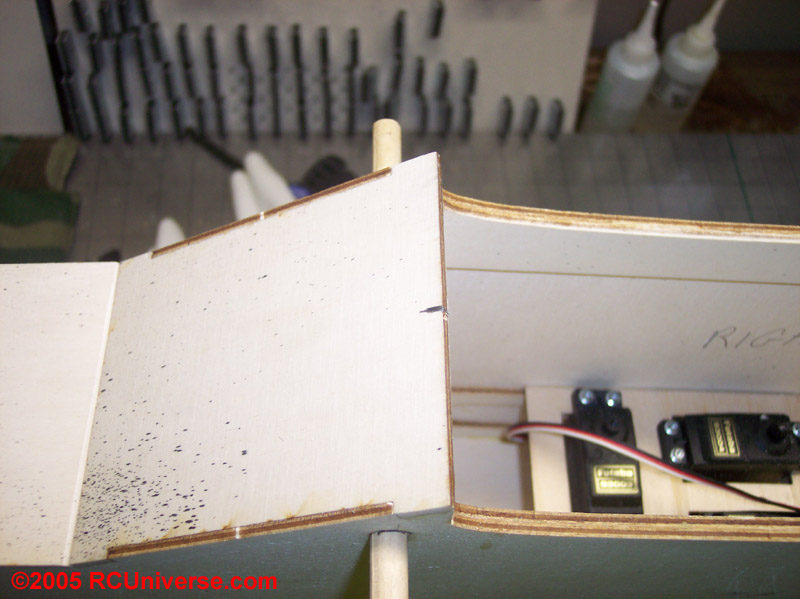

The wing is held on by rubber bands that are hooked to two dowel rods, one mounted at the leading edge of the wind and one at the trailing edge. We need to go ahead and glue in these rods now. Before gluing them in place make sure that they are centered on the fuselage, with the same amount of the rod extending from the fuselage on both sides (pictures #1 and #2). Once you have the mounting location determined go ahead and glue them in place. Some will tell you that you need to use epoxy to glue these dowels in but I consider that overkill. Wood glue or CA will hold fine here. Pictures #3 and #4 show the dowels in glued in place. As I said above, we'll determine the exact location of the wing after we cover the plane, but for now we will mount it so that it's square with the fuselage. Mark the centerline of the fuselage at both the leading and trailing edges of the wing, and set the wing on the fuselage with the center of the wing aligned with those marks (pictures #5, #6, and #7). Picture #8 shows where we are at on the build so far.

1. Measure the distance of the dowel extending from the side of the fuselage. Ensure that it's the same on both sides.
