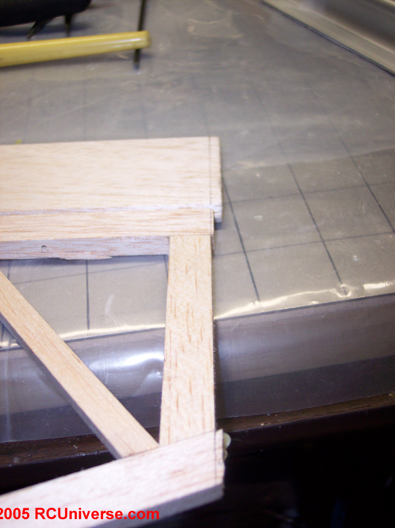

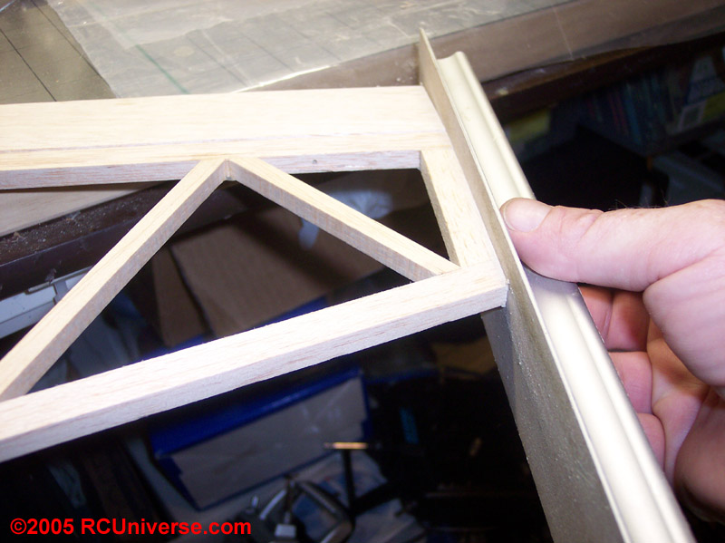

As we assembled the tail sections you may have wondered to yourself why we didn't worry about the edges of our assemblies being perfect and square. That's because it's a lot easier to square up your work after you finish it than to build that way. In picture #1 you can see exactly what I am talking about, the edge of our horizontal stabilizer is pretty ragged. So let's get that cleaned up. First thing to do is to mark the straight line that we need to get the surface down to (picture #2). Use a straightedge to mark the edge of the area (picture #3). Once you have that done go ahead and use a large sanding block to sand the edge of the stabilizer straight (pictures #4 and #5). Picture #6 shows the completed edge. Even though I showed only one side being done here you'll want to go through and do all the edges of our tail section the same way. One of the things we will need to do now is to prep the leading edges of the tail sections for being rounded off. While you don't have to do this I find it easier to do if I mark the centerline of the leading edge. Use a ruler and straightedge to mark the centerline (picture #7, #8, and #9). With that done we can move on in getting the tail sections prepped for assembly.

1. The edges of our tail surfaces are pretty rough after building them.
2. Use a straightedge to mark the edge of the surface
