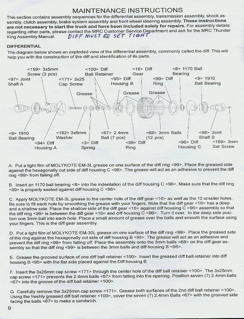

Here is the factory NTK manual that may help some of you.
ID:	576321   Click image for larger version
ID:	576322   Click image for larger version
ID:	576323   Click image for larger version
ID:	576324   Click image for larger version
