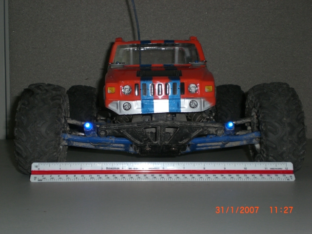

strongest would be the chassis or shock towers stripping out the screw holes is users fault a way to fix it is to take a couple of strands of wire and put them around the screw b4 you screw it in and it makes the screw tight in the hole once you break some front arms you should do the wide pede front its really simple
