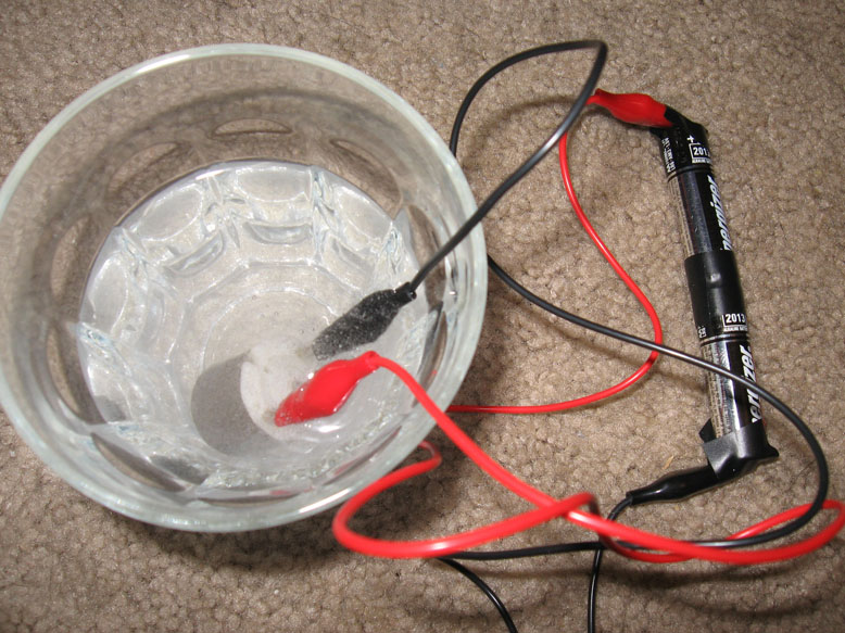

First let’s start with water. The main reasons I have heard to do the break-in in water is to reduce pitting during motor arcing in the break-in, and to keep the temperature down low, and wash away the carbon buildup during break-in. I also cannot confirm this, but I have heard that water break-in’s result in a higher performance motor that doesn’t last quite as long as a dry break-in (more info to come*).
To dispel some myths about water break-in’s, no it will not short circuit, nor will it fry the motor, or over current the batteries or whatever you are using to break-in your motor. To test this for yourself take an ohm meter and place the probes in the water, and vary the distance between them. You will see that the ohm reading is quite high, though it still conducts electricity. Also it should be noted that pure water is among the best insulators on the planet. It is just the ion and particles dispersed in the water that conduct the electricity (such as lime calcium magnesium and salt).
One thing to note with a water break-in however is that it is best to use distilled water if you are going to use water to break-in your motors. The reason for this is because regular water or hard water can leave a residue of minerals on the motor parts, which could cause undesirable performance, or corrosion, and it does not conduct electricity.
Another thing to note with the water break-in is that there are small nooks and crannies in DC motors for water to stay, and over time rust and corrode the inside of the motor. These places include the spaces between the commutator, between the commutator and the armature windings, where the armature meets the shaft, in between the plates of the armature, and so on. All the water needs to be forced out somehow. Taking the motor apart is not preferred because it can change how the brushes seat, effectively reducing your break-in. A lot of people use compressed air, especially the motors with a hole in the side of the can. Obviously the smaller motors are much harder to get the water out of.

If you want to break them in water or alcohol, just follow the above steps; then place only the motor in the liquid (keep the batteries or other power source out). When the hour is up, or the batteries are dead take the motor out of the liquid and blow out all of the liquid that you can on the inside, usually with compressed air, but don’t take the motor apart or otherwise the brushes likely wont seat the same way when you put it back together, and you’ll have to break it in again. Make sure to oil the motor back up. Only get the motor where the shaft touches the bushings or bearings, and use a light sewing machine type oil like 3 in 1. Don’t use WD-40 or anything similar because they are penetrating oils that are supposed to be used for loosening rusty bolts, and the oil just flips off at rpm’s, and can cause extra resistance by getting oil on the commutator (loss of performance). All-in-all these oils are really not made to lube.

Water Break-in with Batteries, (Bubbles Note the Motor is Spinning)
