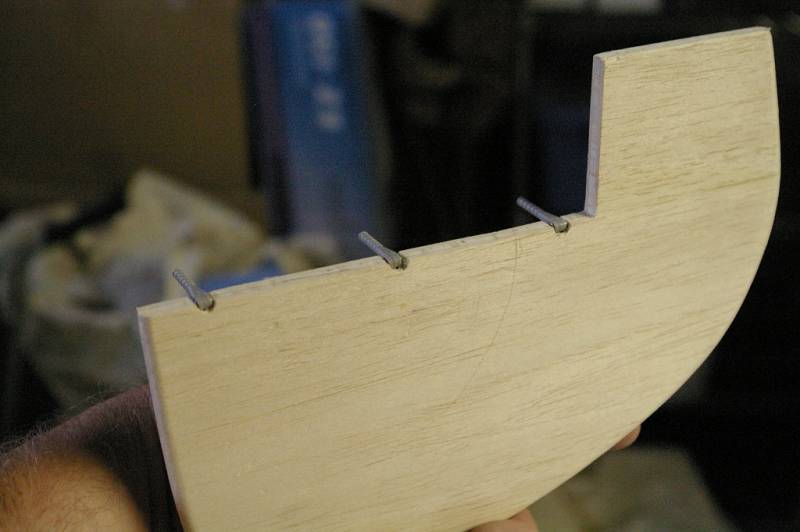

I just got done doing all the Hinges on my Sweet Stick.. here's how it went.
I took most of this from the Robart hinge Howto on Airfield Models.
Don't bevel the surfaces before drilling the hinges.. Do it after the holes are drilled.
Pic 1.. Figure out where you want the hinges on the plans..

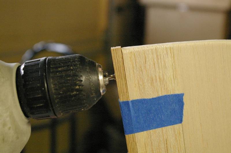

Pic 2 Since the Stick has a 1/4" stab I got a 1/4" square hardwood stick to use as a drill guide..
Mark the hinge lines on the stick and down the center.. Then drill through the marks on the drill press.
If you don't have a drill press just be extra careful to get it through the same spot on both sides..
I'm using 1/8" hinge points so it's an 1/8" hole. When it's done I tape it on to the rudder with some blue masking tape..
I tried clamps.. this is better. mark one side as pointing to the stab.. the other to the rudder in this case.. You don't want to get it turned around later.
