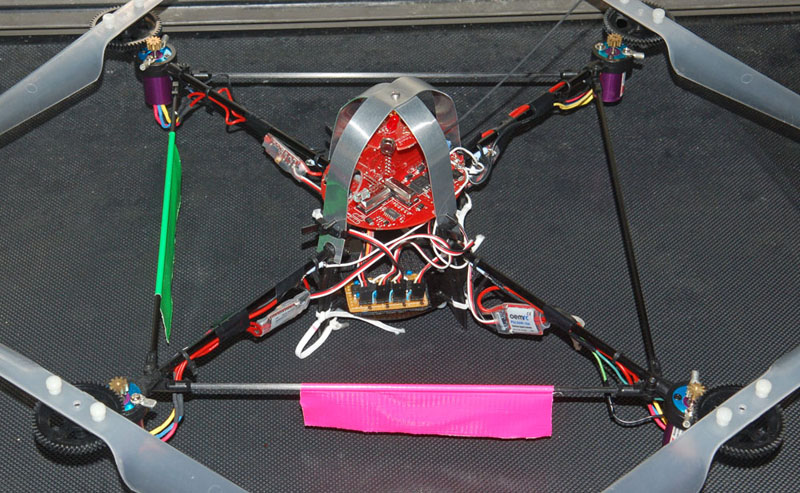

The Draganflyer has been successfully converted from brushed motors to brushless motors. This conversion can be done for approximately $220. The advantages of the conversion are:
1) An increase of 2x to 3x payload capacity.
2) Longer flying time for a given payload.
3) No fragile DC motor wires to protect.
4) Smoother hovering
5) Higher power for more controlled descents with heavy payloads
Complete documentation of the conversion is available here:

The two pictures below show the converted Draganflyer and a camera shot made with it from 200 feet using a custom camera mount discussed here:
[link=http://www.rcuniverse.com/forum/m_5967964/tm.htm]Custom Camera Mount Thread[/link]
