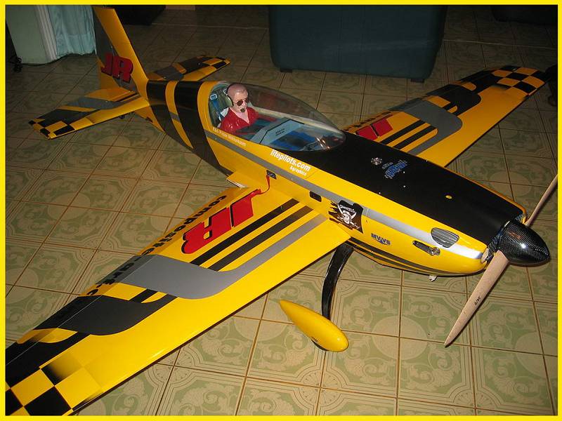

I just finished building the new plane of Composite-ARF EXTRA 330L 2.3m wingspan with MVVS 58 and KS Canister. Here is the specification.
MVVS 58
KS Canister
JR8711 x 2 for Aileron
JR8711 x 2 for Elevator
JR8711 x 2 for Rudder
HITEC 325HB x 2 for Choke and Throttle
Battery FROMECO 5200 mAh with FROMECO Adjustable Voltage Regulator and FROMECO Badger switch for receiver and servos
Battery FROMECO 2600 mAh with JR Heavy duty switch for Ignition
DUBRO 24 Oz tank
4" PETE CARBON FIBER Spinner
MENZ 24 x 8 (during break in period),......will change to 24 x 10 CF after break in
Peak at this time with 24 x 8 at 7000 rpm.
Please see link in details of every steps built.
