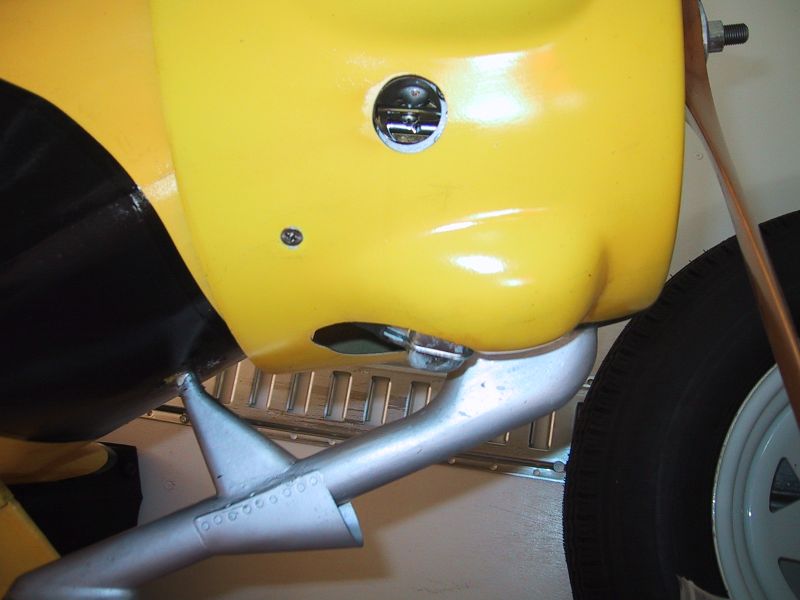

When I first flew my Jungmeister with a Sachs 4.2 the engine just didn't run right. The carb was close to the cowl. I had resisted cutting a hole in the cowl but finally gave in. It's been running great for the last 60 flights.
