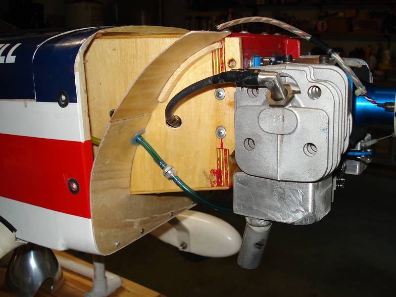

I seized on of my jugs before I baffled my engine. Since then I run lower than 200° F. Important is also the rear baffle or deflector, which directs the air straight out the door.
