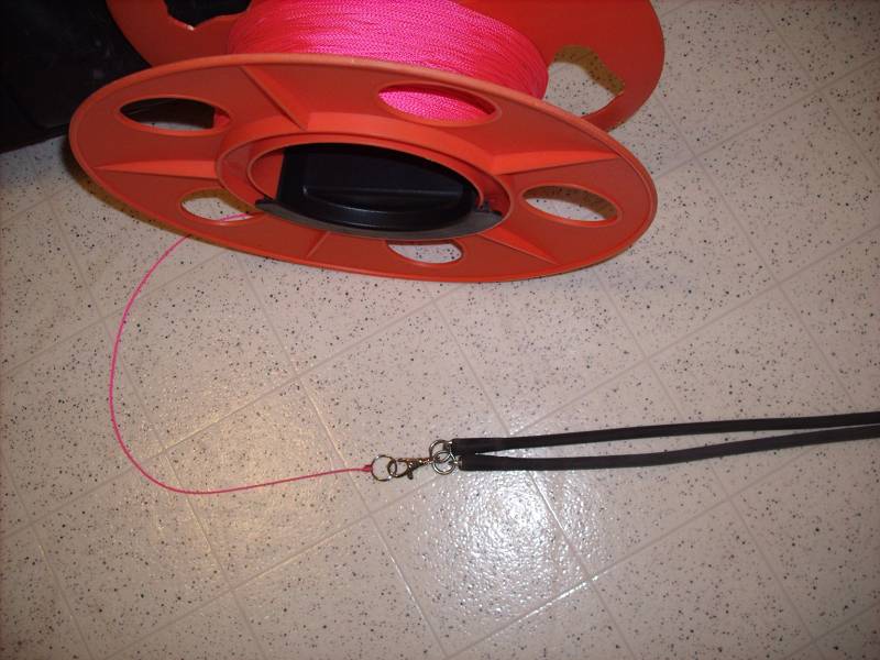

The HoseMonster rubber I have in the 2, 3 and 4 meter class... They are mandrel dipped and heavier wall thickness than the Dynaflight Heavy-Duty and seems to have a much smoother pull to them... I have them "ringed" at their 50' marks and can adjust the length with qiuck release hooks depending on the size field that I am flying at... I am using 500' of 200lb massion line also "ringed" at the 250' mark for adjusting to the size field... This seems to be a good way of doing this and I can also add sections together if more pull is needed by using (joining) the rubber in parallel (tandem) such as a 50' length of 2 meter rubber along-side with a 50' 3 meter rubber... I did spend close to $400.00 (i've spent at least as much on all the cheap ones added together) on all that rubber but have found it to be well worth the cost... No more cheap rubber for this guy, I have learned my lesson...! I also use the aerospace protectant "303"

Hi-Start in Kelty Binto Cooler / Hi-Start with quick realese / Hi-Start in parallel (tandem) configuration
