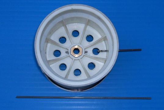

WHEEL PINNING/TRIMMING OPTION FOR M/T TIRES...
To help stop the hexes from spinning in high h/p kits they can be pinned using small hobby store ready rod, use a small correct sized ready rod sized drill bit, drill through the center of the rear wheels through the hexes on each side and press in a short length of ready rod, use a bit of c/a glue after wards to help hold the pins in.
Also for some foam filled tires, the inner tire bead lips could be cut off if needed to help the movment of the tire on the rim.
