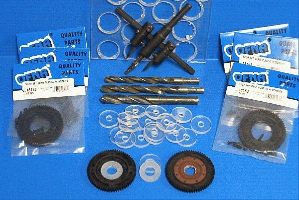

65T MONSTER PIRATE SPUR GEAR MOD OPTION...
When there was a shortage of factory spur gears for the nitro TK, we started to use the 65 T ofna monster pirate gear which turned out to be a better gear because it was a bit smaller 65 toothe VS 67? for stock, this gave a bit more clearance under the a arm support block which is helpfull. all we did was cut a washer spacer from lexan to center the gear and used set screws run through the gear to hold the rulon pad on. I am sure with so many 8scale kits out now today even other kits gears could fit too.
