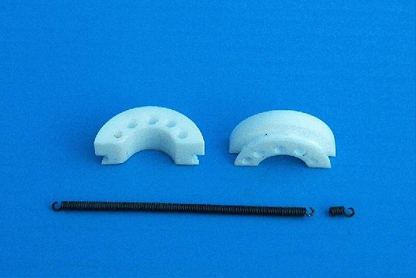

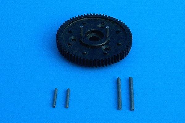

17T FACTORY CLUTCH BELL, FLYWHEEL PIN, SHOE MODS...
A punch can be used on the clutch bell to help stop the gear from spinning on the bell if needed.
An extra bearing can be installed with a spacer to help with the bearing load.
One size larger hobby store ready rod can be used to upgrade the smaller fly wheel pins, compleatly drill out the factory holes with the correct size drill bit and hammer in the bigger ready rod with a bit of red locktight on them, cut/grind to correct length afterwards.
The factory clutch shoes can be modded/played around with if needed by drilling some holes in them to make them lighter, the spring can also be shortened 1/8, this will give a higher rpm engagement on the clutch if needed.
