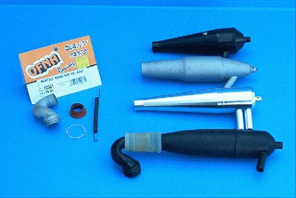

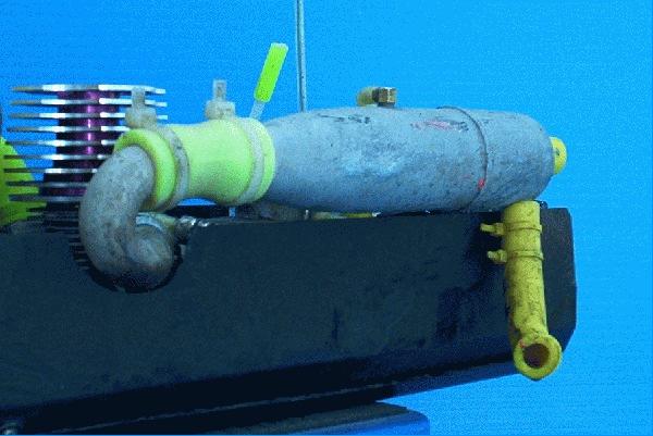

FACTORY/AFTERMARKET TUNE PIPE MODS...
The factory tune pipe can be shortend on its end a 1/2 to 3/4, this will help with tire clearance and a bit more top end.
Using a ofna header #10061? will allow any tune pipe to be used.
