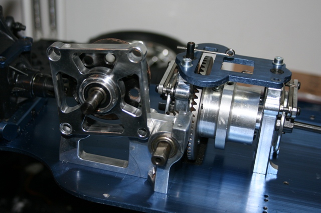

one thing I have noticed that I dont understand about this full time 4x4 is.....when I lift the rear wheels off the ground and give the buggy gas.... the front tires dont pull the buggy out of my hand....when the rear dive bone came out of the cup the motor just reved
Nice review foxy.....
I would assume it is due to the center diff not being a locked/LSD. I installed a FG LSD in my Titan, which I feel should solve this problem. I just haven’t had a chance to try it yet, but will let you know how it goes.
