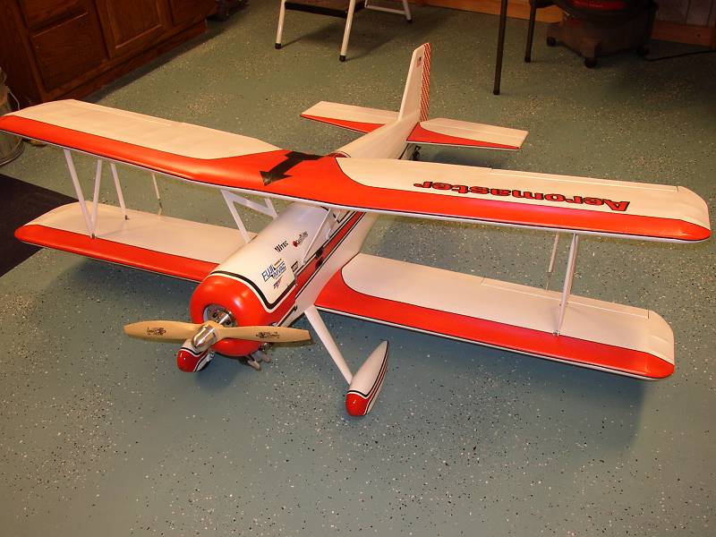

I am attaching a couple of shots of my Aeromaster so you can see the finish. It is a GP ARF but I don't like Monokote so as soon as I got it I stripped it and did a re-cover with 21st Century Super-Coverite
fabric. Used antique because I had it but sure did hate to cover it with paint. I sprayed it with Behr Latex exterior house paint and after trim and decals sprayed it with water based clear polyeurethane Satin Finish. Gives the fabric a nice soft sheen. I plan on doing my E-III the same way except leaving the antique unpainted and just the clear Satin.
