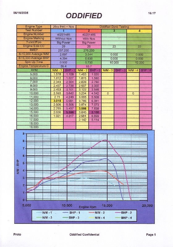

Here a dyno for this engine with and without nos
Complete 26cc heli engine fitted with nitrous oxide system. This is a serious engine, complete brand new 26cc heli engine(never been fitted in a car, only dyno tested) fitted with a professional nitrous oxide kit. Dyno tested up to 12 bhp!.
Basically a complete motorcycle nitrous kit, including a 0.5kg nitrous bottle, solenoids(wet system), range of jets etc(additional 2.5bhp upwards…). The nitrous system alone costs over £500
Custom made nitrous controller pcb, engine rpm input with throttle servo connection, automatically operates n20 system at full throttle and between 8000 and 18000rpm.
Obviously this engine cannot be used in any racing series!, but as a fun/demo engine fitted in a monster truck or similar, it would be outrageous!.
