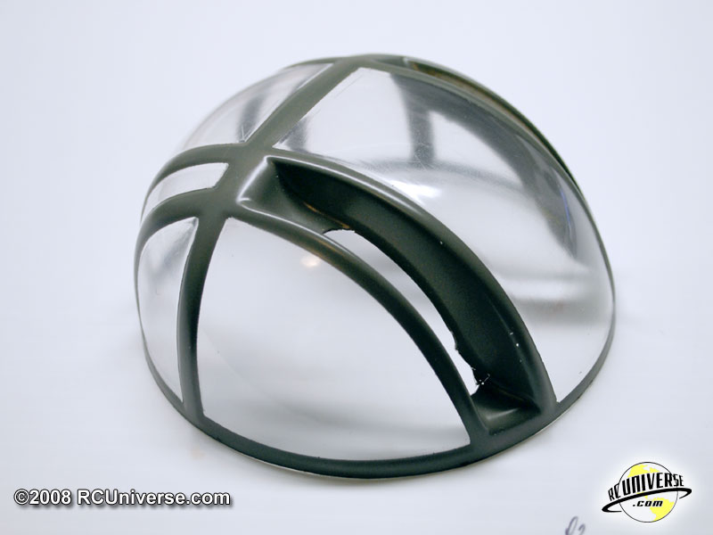

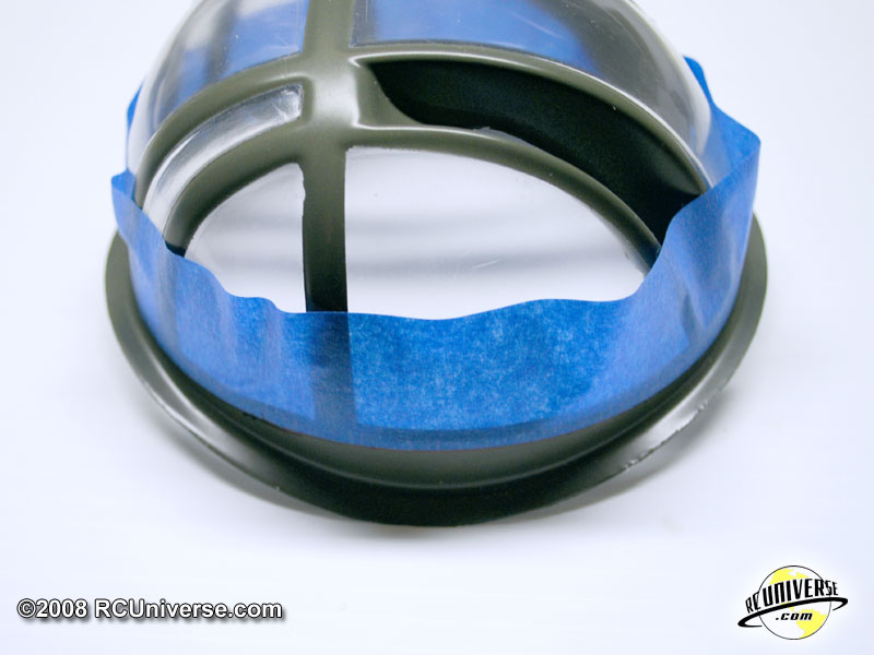

We’re in the home stretch now on completing the Top Turret. The Wingspan Model’s add-on reuses the original turret, but we’ll need to cut it down a bit. I found that the easiest way to get a good straight line to cut on was to use tape. Since the original turret went around the curve of the fuselage it isn’t straight around across the bottom. Looking at the turret you can see that the front and the back of the turret have less material than the sides, so we’ll use those as the guideline for cutting. I placed blue painter’s tape around the turret to get a good straight line, and then used a Sharpie marker to mark the cut line. I then used scissors to cut the turret off at the line. Take you time and cut slowly as to not cut too far. A pair of curved shears works much better when doing this work as it’s easier to get in and cut along the line (I loaned my pair out and never got them back, that’s why I’m stuck still using straight scissors). Test fit the cut turret on the cylinder and trim if needed.

1. Use tape to establish a line around the turret.
2. Use the tape line to mark the turret for cutting.

6. Completed turret.
7. Completed turret.
